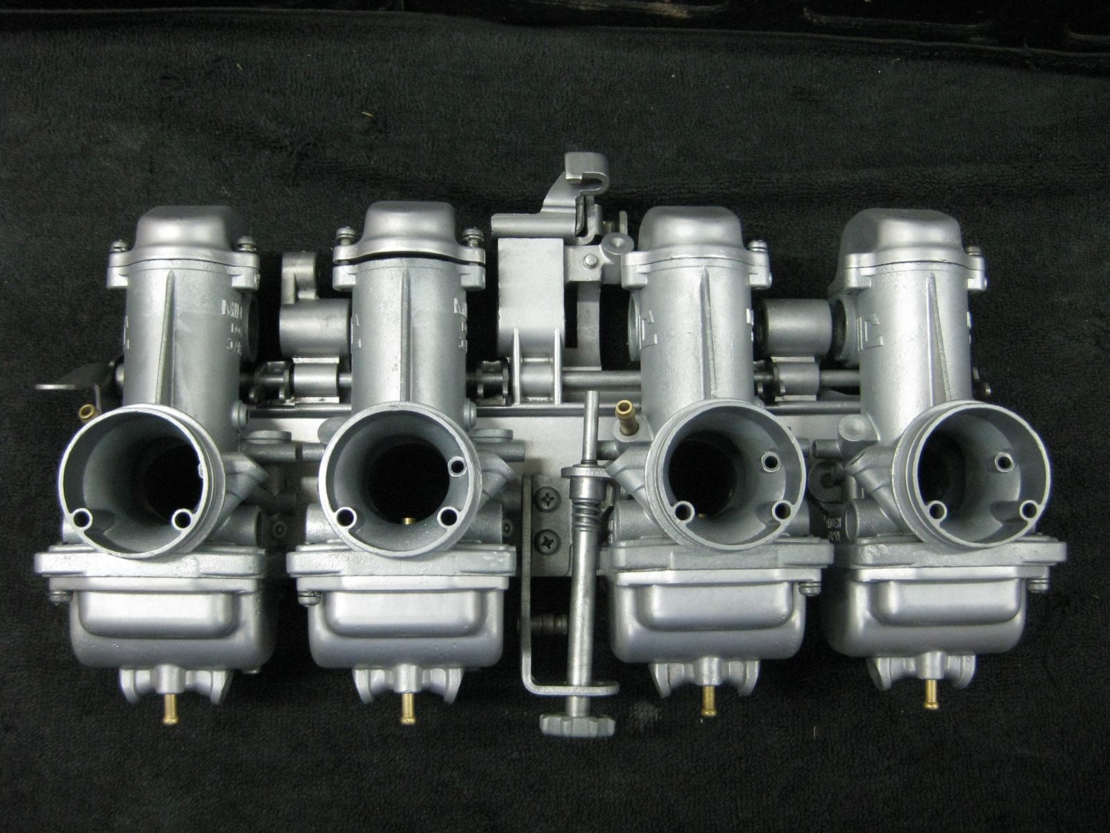

Got my carbs "Hydrablasted" recently and thought I'd share some pics of the job.
A mate did these for me - inside and out and they came up pretty good
- nil damage and a lot of crud/surface corrosion has gone and a now have a durable surface which
is I'm told "fingerprint resistant."
Will give 'em a bath/blowout before re-assembling - as advised.

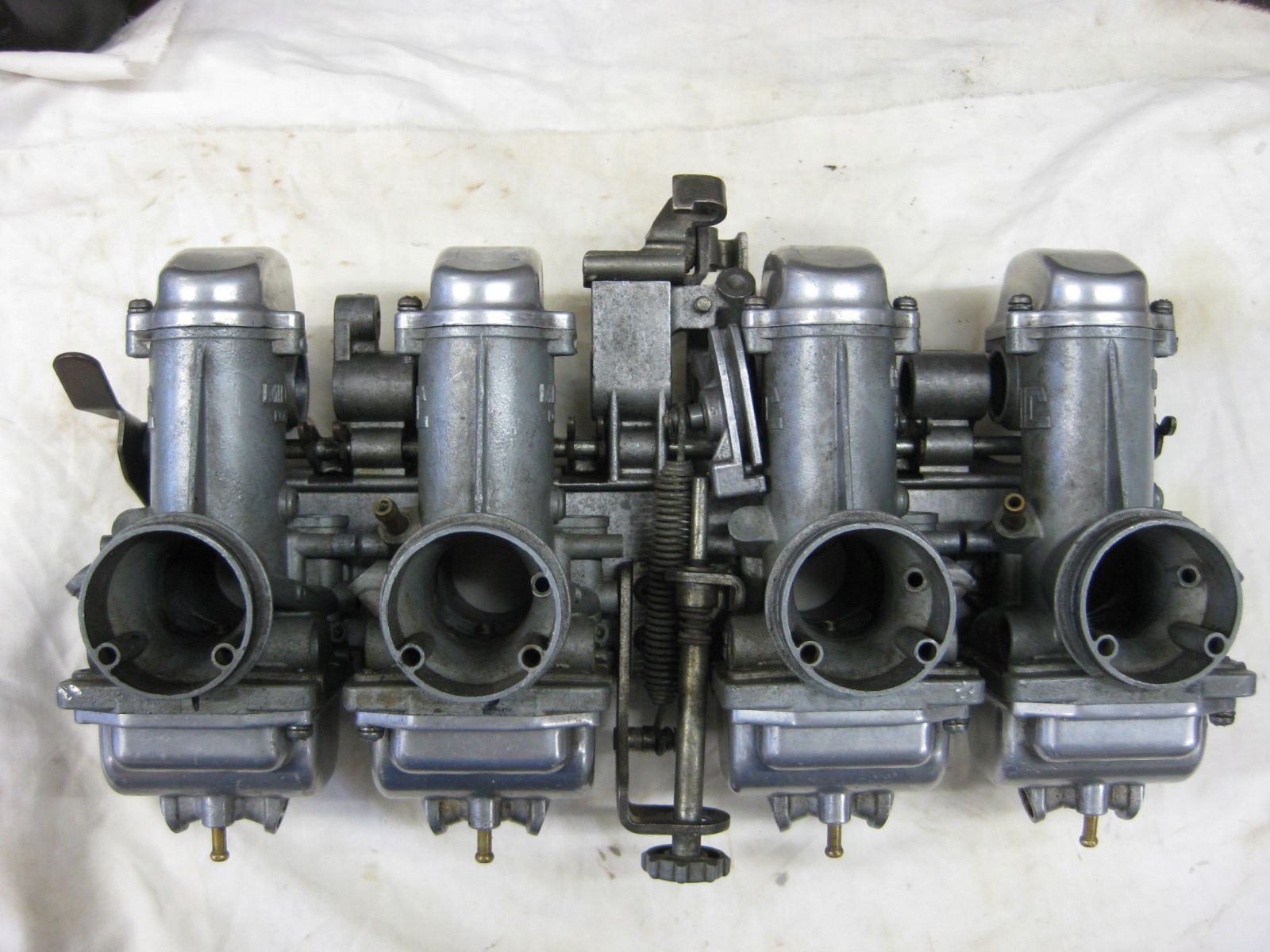

Pic of carbs before blasting

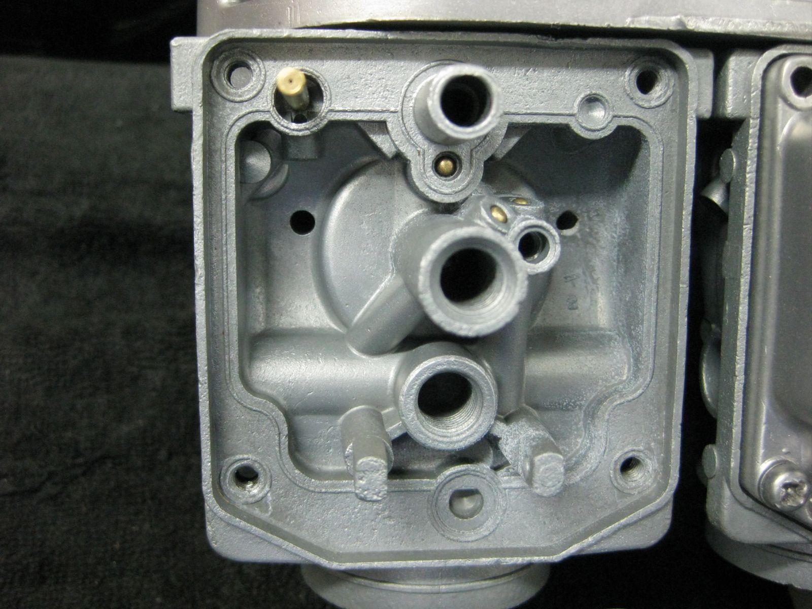

and one more - float bowl.

Dayuumm! What is this magical "hydrablast" that you speak of, and where can one find the hydra to blast with? :silly:
I'm about to clean some vm28s and they're pretty nasty. I'll have to google hydrablasting and see what options there are.
Those are some pretty carbs, dude...was he able to clean out the channels as well as he got the bodies?

Re: Carb Rebuild
15 Aug 2015 09:00
It looks like your mate didn't pay much attention to the carb configuration when he reassembled them. He mixed them up on the rack. :dry: Ed

Re: Carb Rebuild
15 Aug 2015 10:28
Good eye Ed .....plus the air adjust screws are all facing in instead of out too.....

All you eagle-eyed blokes spotted the "deliberate" assembly errors!
(I actually number-stamped the carbs prior to sending them away to ensure correct and easy assembly -
although gurus wouldn't need to do this as it would be obvious to those with more exoerience)
The lesson here is to not assume that a re-assembled unit - such as a bank of carbs
has been put together correctly - unless it's been done bysomeone who is qualified .
Always check against your parts book/workshop manual.- or with our KZ-R gurus!

"...was he able to clean out the channels as well as he got the bodies? "
Hey Aphex, yes the channels (ports/holes/pasages, or whatever you wanna call 'em)
got the same treatment and as far as I can see all are clean and clear.
I will be giving them a wash in warm soapy water then a blowout to ensure no blasting medium
is left behind before I rebuild and refit.
