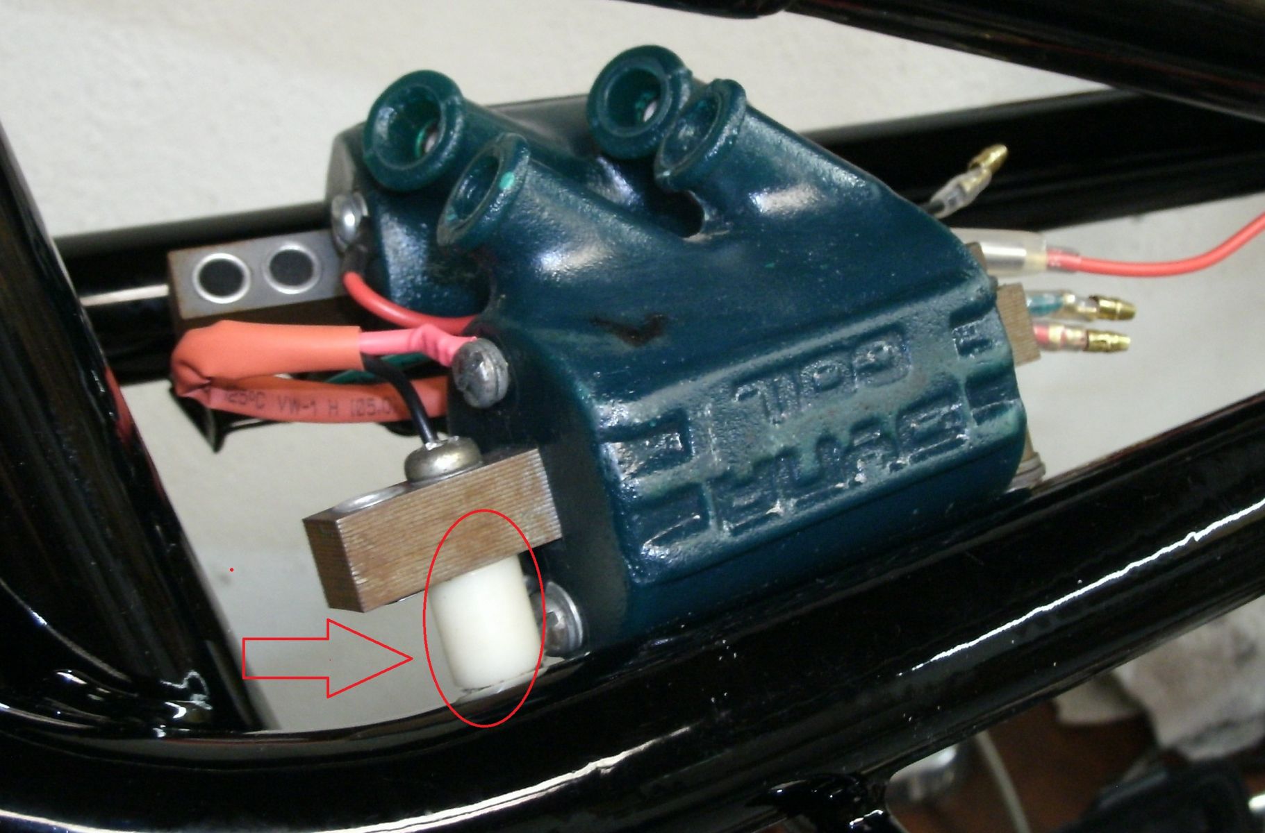

If not already done, would assure that heads of screws attaching wires to coils' primary terminals aren't shorting against a coil mounting spacer.
In the following example, the metal spacer has been replaced with a non-conductive (plastic or nylon?) spacer.
