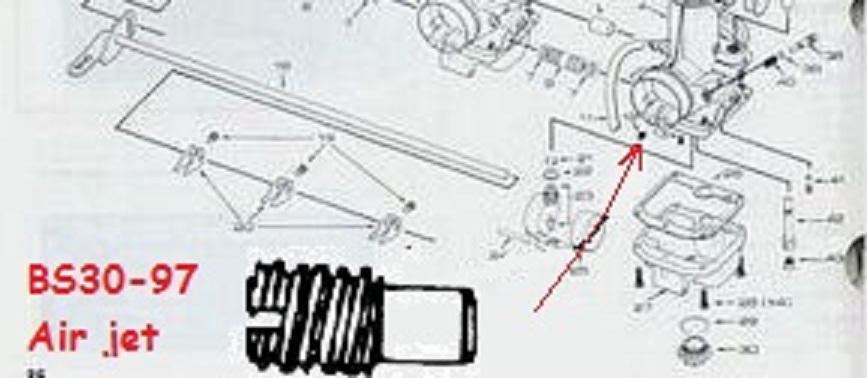

Air screw at 1/4....my previous k1000 ran great with
125 main
20 pilot jet
2 turns out air pilot
Stock turns on pilot is 1.3 with 1/4 either way.
If it does not run right at idle then check your air jets
125 main
20 pilot jet
