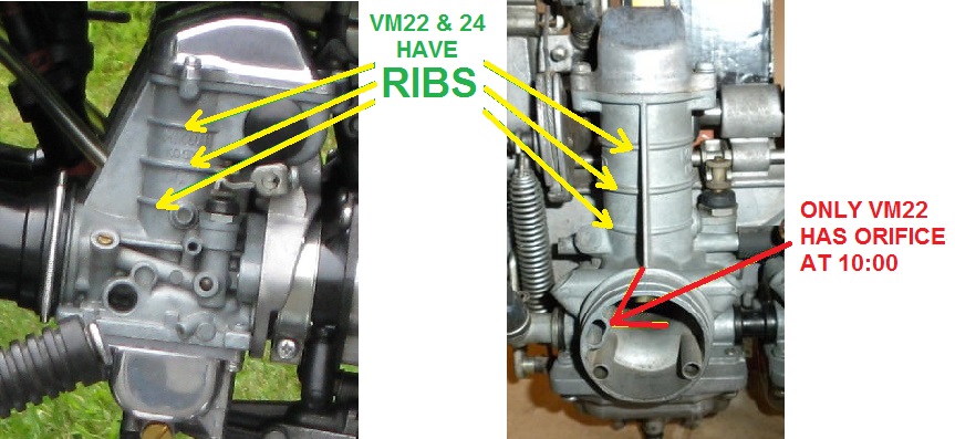

Actually, some of the 1977 VM24SS carbs had air screws (mine do). None of the 1977 KZ650's originally came with 22 mm carbs. Those were put on the 1978 B2A and 1978 D1A. So assuming his bike really has 22mm carbs and that it really is a 1977 model someone pulled a switcharoo. Just for reference, the Mikuni VM22 carbs have the orifice at the 10:00 position shown below; the VM24 carbs do not have it. Ed
