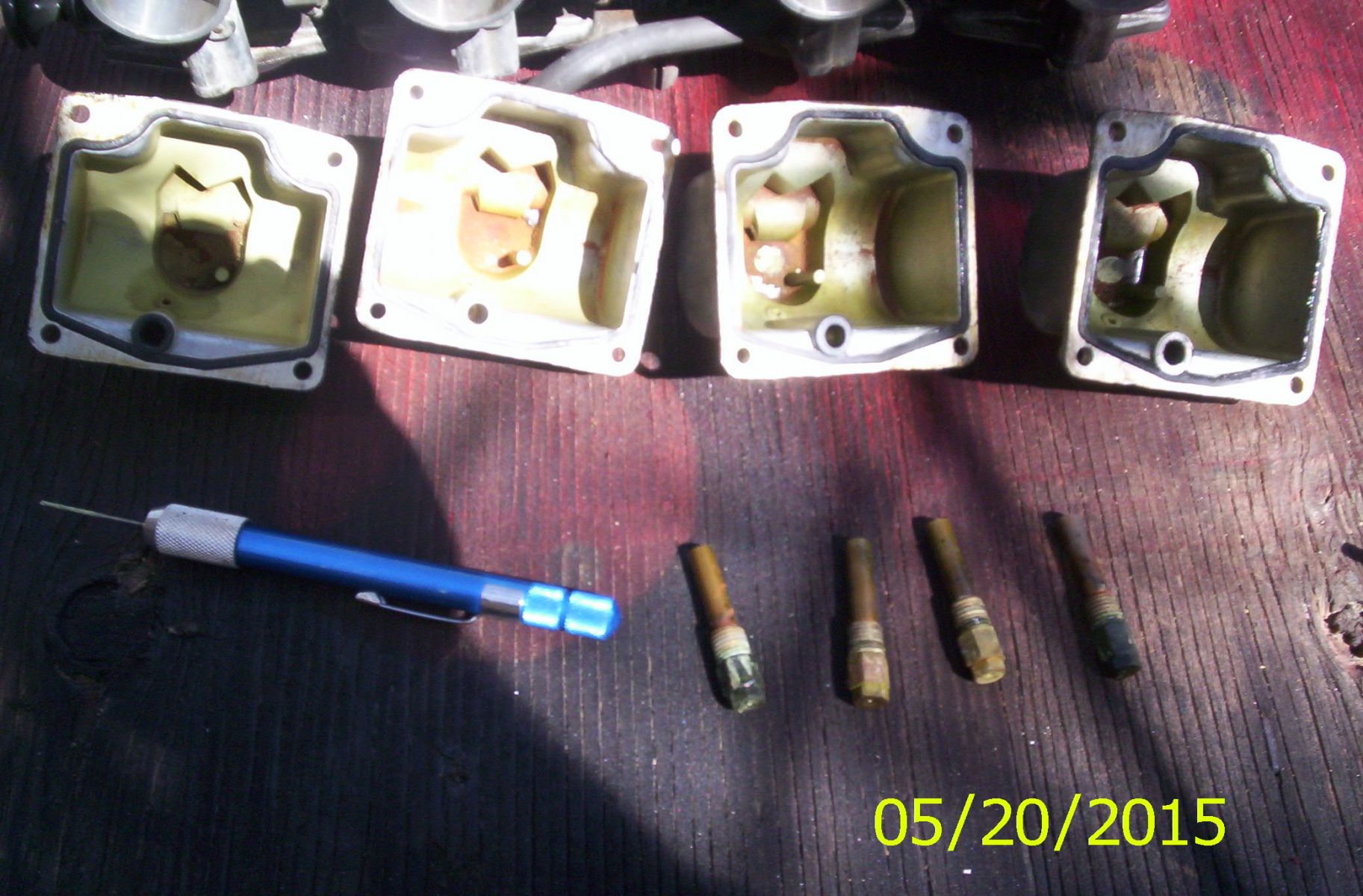

First some background...You can see my motorcycle details in my signiture. But This problem has existed since I bought the motorcycle, before putting pod filters on. My motorcycle has always taken a couple seconds to start up, and I have to give it a bit of throttle or I do not think it would ever start. Struggles to idle until warm. I have cleaned the carbs multiple times and they are very clean. Once warm the motorcycle runs great all through the rpms. Once warm it will start right up with no throttle. I am pretty sure the valves are out of spec and need to be adjusted, I would also imagine the carbs need to be synch'd. With those two things, I would think that it would start easier and idle cold.

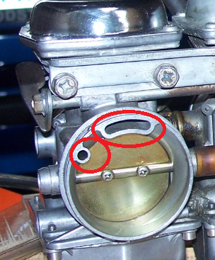

Second thing is to check your pods. Look at the picture below and then look into one of the Emgo pods and look for a rim which might obstruct the red circled openings in the pic. Some cheaper pods are shaped so that they will block those openings. K&Ns are fine but not sure about Emgo

JR - The butterfly's definitely open and close. Also yeah I have seen pictures like that before while I researched about buying pods and their possible issues. My pods partially block those but I think it's safe to rule that option out since the problem existed before getting pods correct? I do need to adjust the valves, I'm sure that contributes to the problem. I will try to check the float levels tomorrow. Also, I did see your post, sorry to confuse you :blush:

I don't think you will be able to get it running correctly with those ports partially blocked. CV carbs already don't like pods, and partially blocking the port that leads to the diaphragm will cause issues.

You can cut a little with a utility knife to take the sharp edge down like a slope.

Yeah, before I installed the pods I decided that if it ran crappy I would cut them. However it runs great all through the rpms so I decided not to mess with a good thing. The starting problem really was just as bad before pods. In fact it was worse. Because now when it's warm it starts right up. With the air box it still took a minute when warm or cold. It runs better now than before, so that's why I do not think pods have anything to do with it.

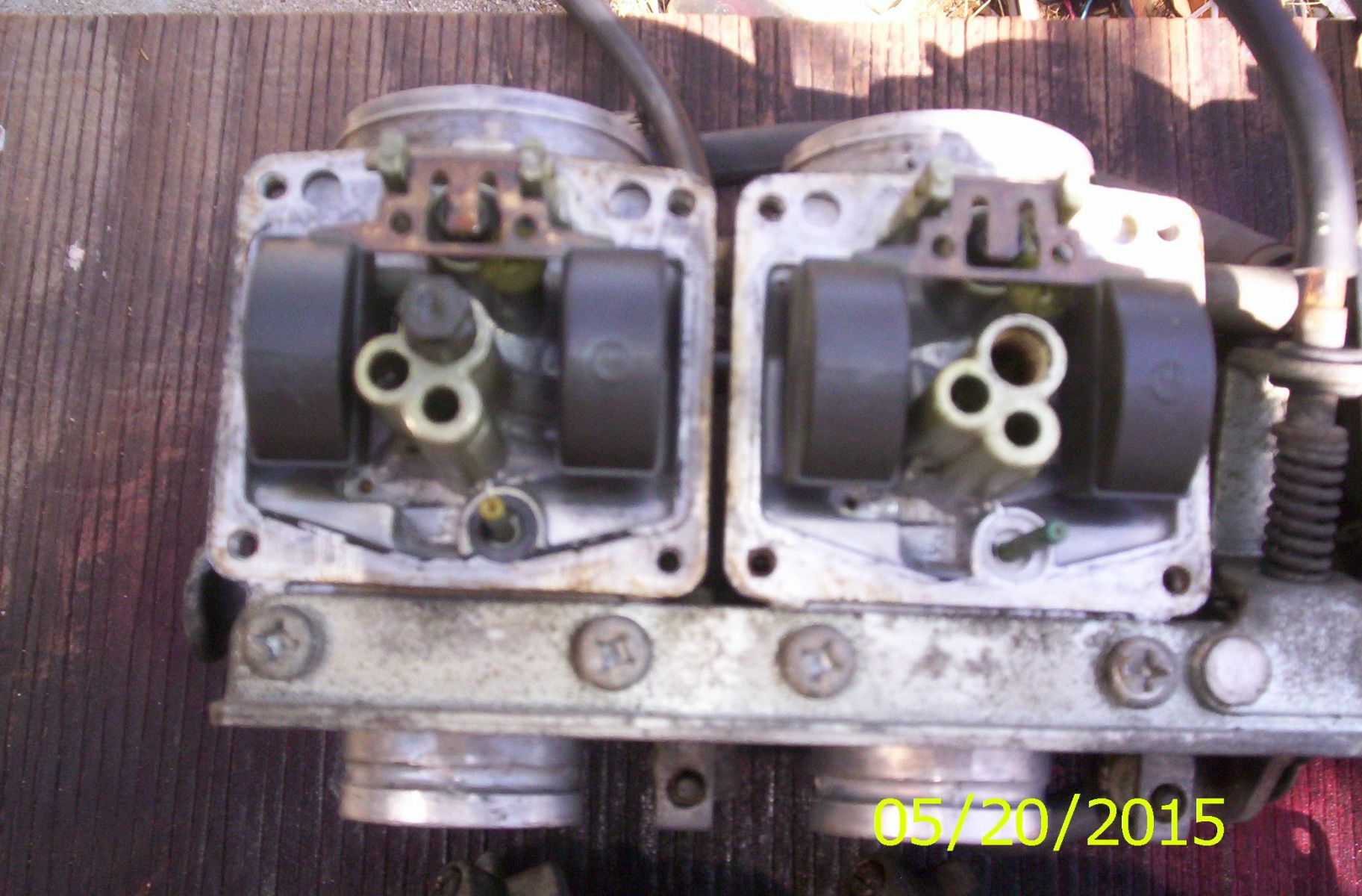

21 May 2015 20:00
No, I'm talking about where the brass tube goes. Do you have a pic of your carb. might be different.
