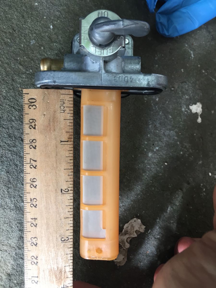

I've got a 78 650 and my manual says I have a 3.7 gal tank but I've never been able to pump more than 2.8 gal into it. It seems to have some kind of issue when it gets low with actually using that last gallon. I've been stuck on the side of the road, with the petcock on reserve and I could still hear sloshing around. Anyway, my mileage is about 35mpg and I'm getting about 80 miles now that I have worked out all my engine issues.
I did replace the petcock a year ago, could that cause it to not drain the tank properly? Or maybe it's losing vacuum for some reason?

01 Jul 2015 18:01 - 01 Jul 2015 18:12gcphoto wrote: ........I did replace the petcock a year ago, could that cause it to not drain the tank properly?
Yes. If the petcock you installed is not the same as the original it may not (and it sounds like it is not) have the petcock intake tubes oriented such that they are permitting all the fuel from being drawn from the tank. It sound like both tubes are too high in the tank. If you're getting 35 mpg you should be able to go at least 100 miles before hitting reserve. Once you hit reserve you should be able to go another 20 or so miles before running out of fuel.
If you have the old petcock you may want to remove the new one and compare the length of the intake tubes from the mating surface of the petcock where it contacts the tank. The stock '77 KZ650 petcock has the reserve tube (actually just a hole) flush with the mating surface. Ed

- gcphoto
- Posts: 77
Re: 79 miles per tank of fuel 83 KZ1100
01 Jul 2015 20:22
As it happens, I had a local shop do this for me last summer because I was slammed at work. So there's a good chance it is not correct. I'll check this out!

- gcphoto
- Posts: 77
02 Jul 2015 11:41
Apologies for thread hijacking.. this should be a quick answer though.
Hey Ed.. I pulled the petcock and it not the same as the one in your photo. I'm not sure how to remove the strainer without breaking it so I left it on. The main tube in yours is only 1 3/4" where the main tube on mine is 2 3/4"! I suppose this explains why I have to hit reserve so soon. I just bought a petcock on ebay from the same year and model. '78 650D. I'll try that out and see what happens. I guess there's no way of swapping the strainer and tubes? I don't see anything for this model on z1enterprises.com.

- missionkz
- Posts: 1622
- Thanks: 184
02 Jul 2015 11:54
Isn't that interesting!??
Mine is about 1 1/2" long.....
If you can't find a shorter one, I'd yank it off and trim the brass to about +1 1/2". Then use good line filters after the selector.
