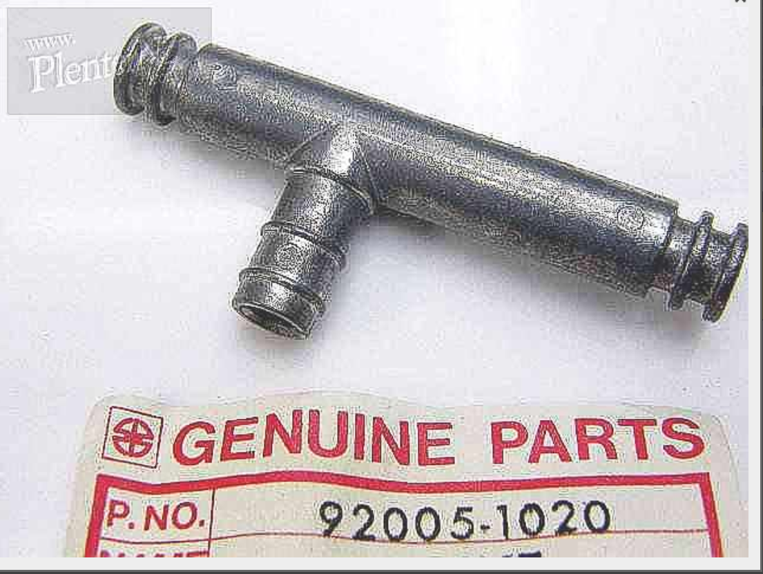

Am thinking the stock fuel line T-joint is probably a metal part, perhaps some kind of pot metal.
For comparison, here's the kind of fuel T-joint ("fuel pipe") used in the KZ900, which has a semi-flexible structure like "built-in" o'rings, and which may be more tightly fitted by wrapping with yellow teflon tape.
Part #92005-1020 is supposedly available from:
www.plenternz.com/product_info.php?manuf...68s6f42uqetreg0vbp53
www.motosport.com/motorcycle/oem-parts/k...x550/carburetor-assy
Hopefully, a couple of new o'rings (Part # 92055-1134) may stop the leaking.
Does the fuel joint at hand appear to be made of something other than metal?

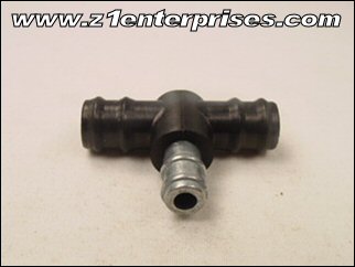

If you know someone with a lathe you can make a T pretty easily. I made this one and it worked perfectly.
