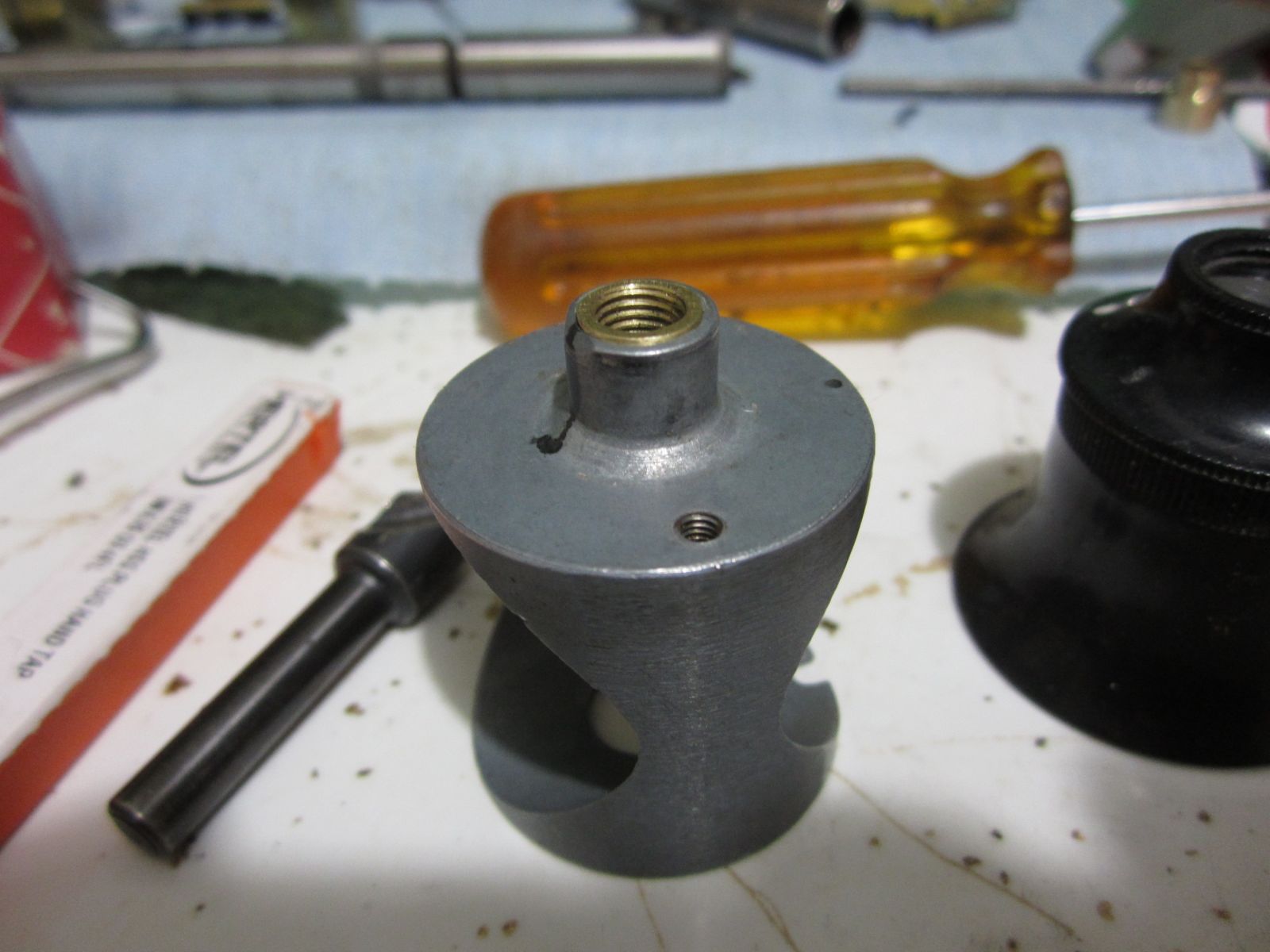

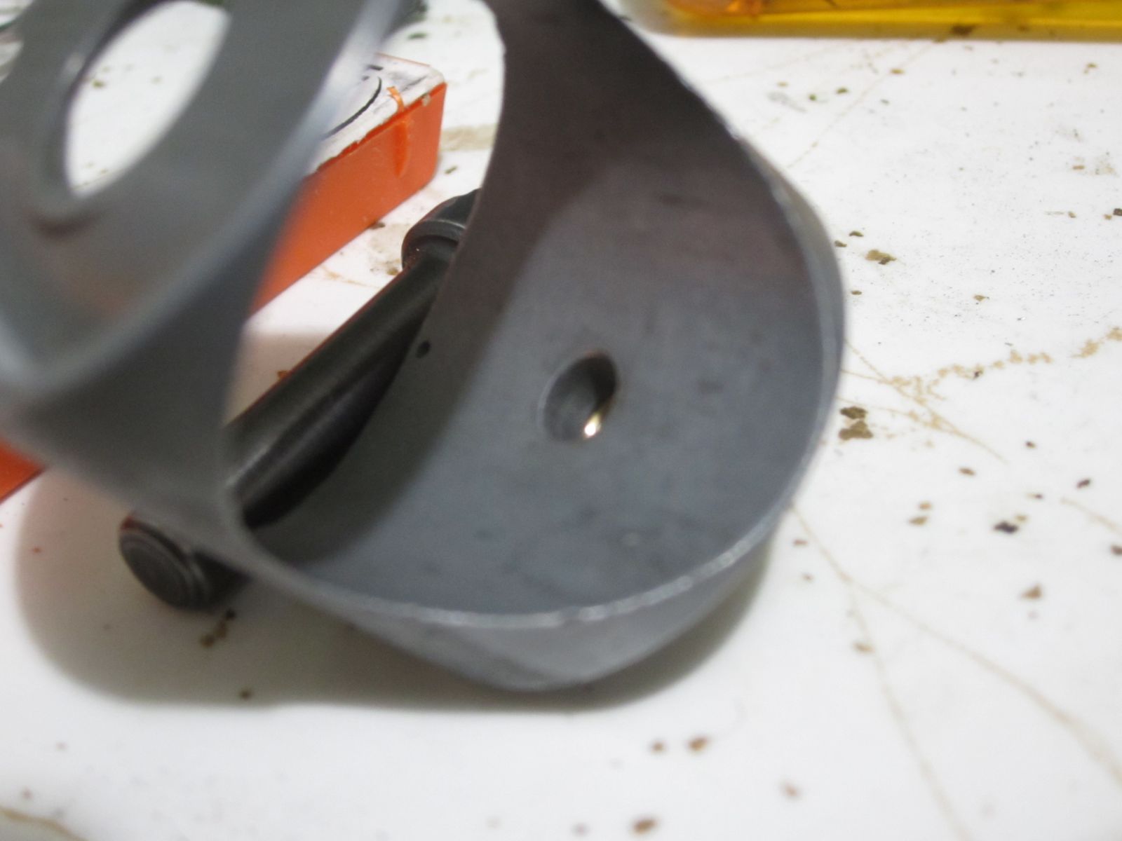

- BlackZ1R
- Kawasaki in my blood
- Posts: 700
- Thanks: 47
Re: VM29 Jet block thread size
23 Jan 2015 23:52
I ended up with a new M6 x .75 tap with D3 class thread made in USA. Needle jet threads into it perfect. I sunk a nice piece of threaded brass into the jet block and ended up with a much better piece than any I could buy new.

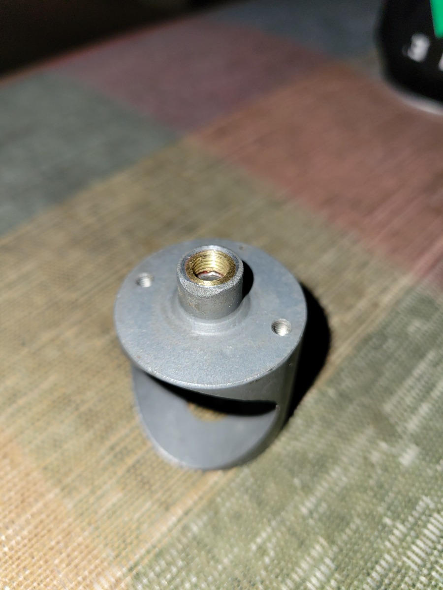

- Posts: 8232
- Thanks: 3613
22 Feb 2023 20:33 - 23 Feb 2023 18:22
I realize this is an older thread, but I'd like to ask Black Z!R a question about this repair. More specifically, did you thread the OD of the brass insert, and if so, what thread size? From reading the thread, I'm guessing yes. Anyway, if anyone knows how to reach BlackZ1R, please share. He hasn't logged in for almost a year, and I'm not sure he'll see this message.
Edit: I made an insert with 5/16-24 threading on the OD, and the Jet Block was likewise threaded on the ID, to accept the insert. Looks like a good fix. 8mm threading would have also worked, but I didn't feel like buying a bottoming tap.
