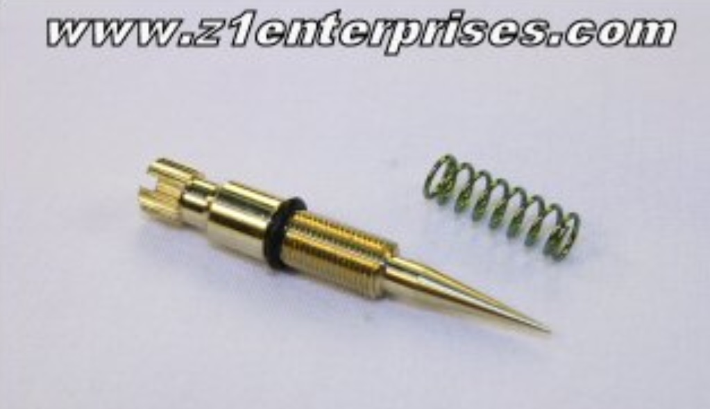

Being careful to remember which carb each pilot screw came out of, could remove them all and compare them among themselves, including any springs, o'rings, and washers attendant to each screw, and paying special attention to condition of the pointed tips.
Presupposing that each pilot screw is the correct part for the carbs at hand, each pilot screw began its life looking exactly like the other pilot screws with the same part number.
www.z1enterprises.com/ItemDetails.aspx?i...carb&item=SIK-1157SK
