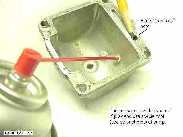

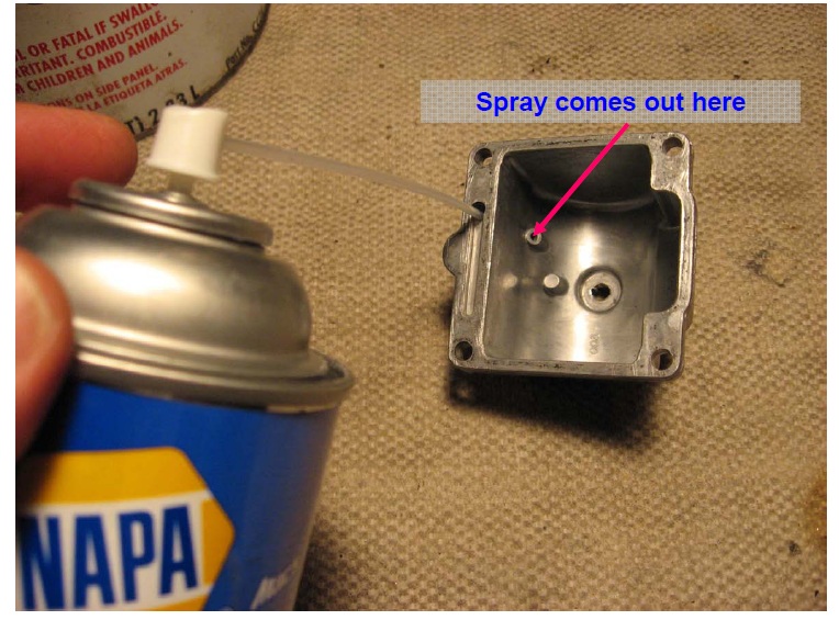

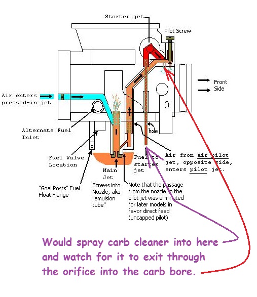

If not already doing, be sure and don't even touch the throttle grip when attempting to start a cold engine.
The enrichment circuit is designed to best perform with a closed throttle.
The enrichment circuit might be obstructed.
Would also clean the passageway in the float bowl.
The above is for CV carbs.
If using manual slide carbs, the same "no throttle while cranking" applies, but the circuit itself is different.
