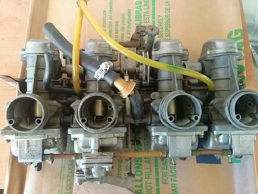

When i bought the bike the carburetor was off and needed work. So i cleaned it and replaced some jets then put it back on, tinypic.com/view.php?pic=10oflsl&s=8#.VDbAFPldU1I
This is like the one i have so i hooked it up according to this but i just dont know where the vacuum line goes.

It looks like you have the two hoses in the pic hooked up where they should be. The black one with the filter takes fuel from the petcock (fuel valve) to the carbs. The other hose sends vacuum to the petcock to open it when the engine is running. If the carbs were just reinstalled, you will need to turn the valve to PRI to fill the carbs with fuel before you try to set the fuel level or start the engine.

Your bike looks like it could be a 1977 or 1978 SR 650. The two yellowish hoses are overflows, the large black hose with filter is you fuel supply from the tank to the carbs, and the last hose is a vacuum for the petcock. Without it fuel will not flow. Just as TexasKZ stated. I have K&N Pod filters and they are a pain in the butt. Just bought a used Air Box Assembly to replace the Pod Filters. Good luck, and keep swinging the bat, you'll get a hit.

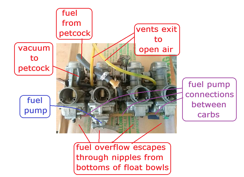

Click here > www.wgcarbs.com/index.php/using-joomla/e...-vm-carb-connections
The following user(s) said Thank You: !Seymore, tdaws92

Looks like your vacuum hose is hooked up correctly in your first picture.
It may be a little long though.
