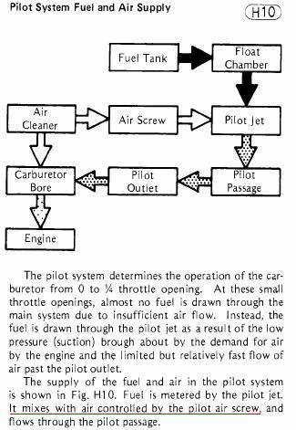

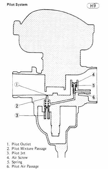

19 Sep 2014 13:19I think you are confusing different carbs. The TK22 screws only ever have air flowing through them, no fuel. Look where they are located, they are on the air horn side of the slide. Fuel screws would be on the engine side.GPzEric wrote: "That will make it leaner. Is that what you meant?"
No - on the TK22 carbs the mixture screws are not air screws, they are fuel screws. Turn them all the way in, and you turn off the fuel at idle.
But that aside, I have the ports mapped out if you'd like to verify.
home.comcast.net/~loudgpz/GPZweb/TK22mai...TK22portRouting.html
The pilot air at opening "G" goes directly to the air screw, before any fuel gets to it.
When I do jetting, I use an ega to set idle, then use a wideband to do the rest of the jetting. it's clear to see the effect of turning the screws out, it goes lean.
Not that it matters, but the screw is clearly listed as an air screw
"16014-1024 Screw, Air Adjusting USA".
And the FSM is also very clear on the subject:
