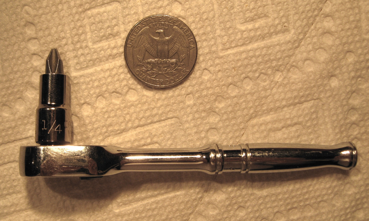

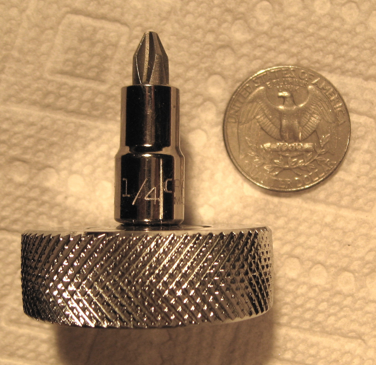

In my novice opinion, Tomolo has a great guide that should be linked to in future carb clean threads. I have taken off my carbs so many times with supposed experts there that it is easy now. Getting it right before putting them back on is the key.
I have no bench carb holder, though getti g one sounds like it would be worth it. Last time I used a 5gal bucket to support the carbs so I only needed to control the front back axis and used my wife's patient hands to keep that level while I added gas and took a pic of the 4x tube levels for reference.
The only way I felt like doing this on bike was acceptable was to replace the float bowl screws with allen hex head to make it not strip out from the horrible angles.
Just to confirm, if floats allow too much fuel in, when the carbs are upside down you would push the tang down to force the float needle to seat higher, right? It seemed like things were getting better, then I got a funky reading and got pissed; returned carbs to bike and it ran better, so I stopped.
