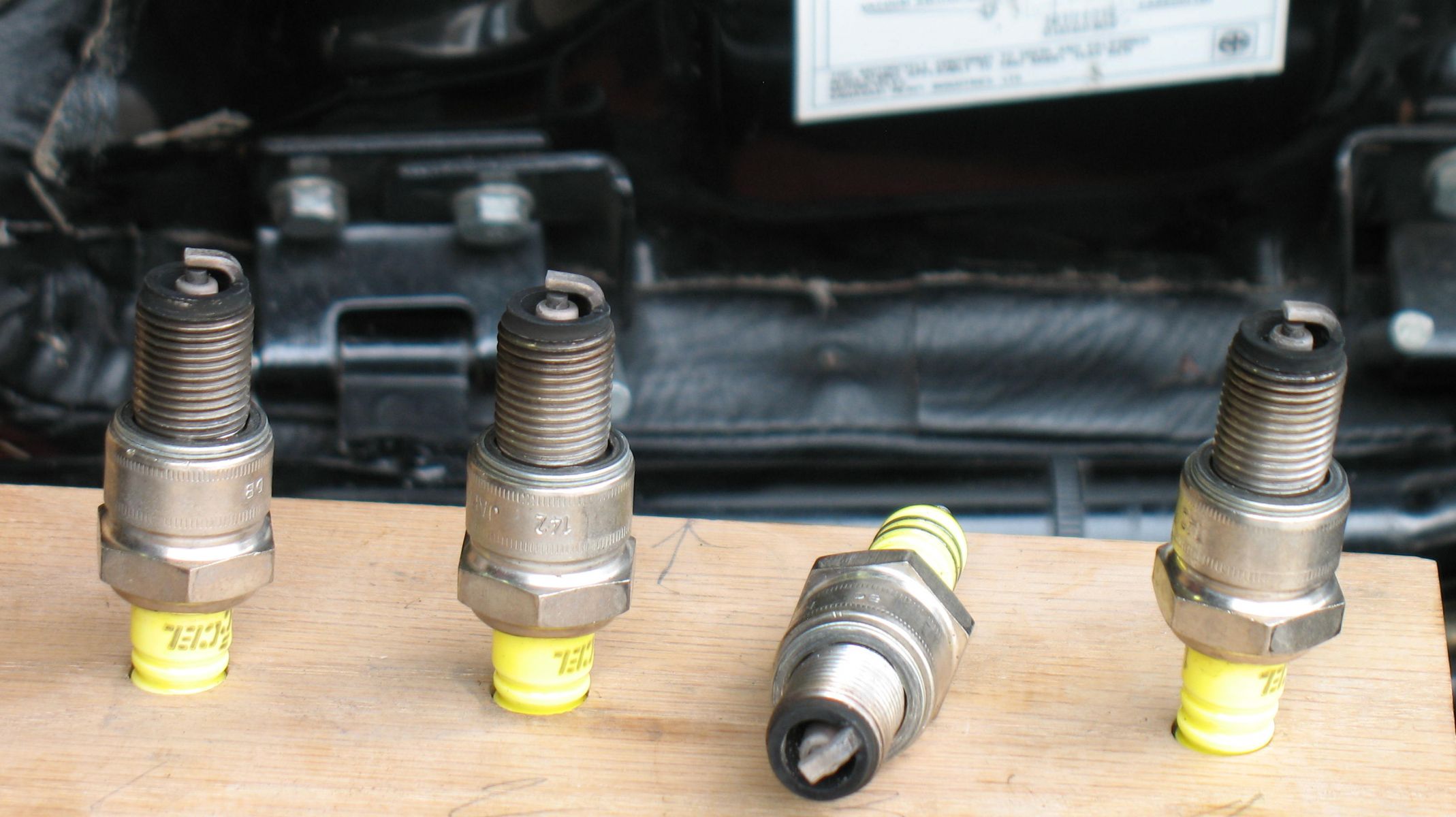

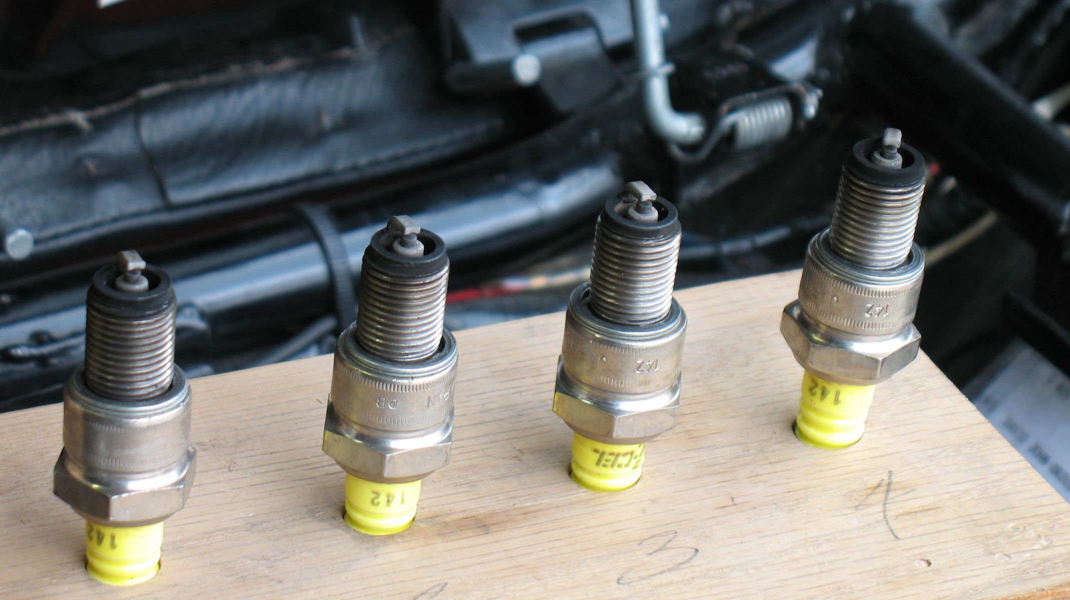

what are plugs looking like?? light brown or black?
At idle, do you smell any fuel in exhaust......rich?

4TheKZ1000 wrote: what are plugs looking like?? light brown or black?
Great questions! I've examined the plugs, and the electrodes appear medium-light brown. The only smell (at idle) is from the crankcase ventilating through a K&N breather; no-longer feeding into the engine through the air box.
I'll pic the spark plugs later today.
A couple pics...

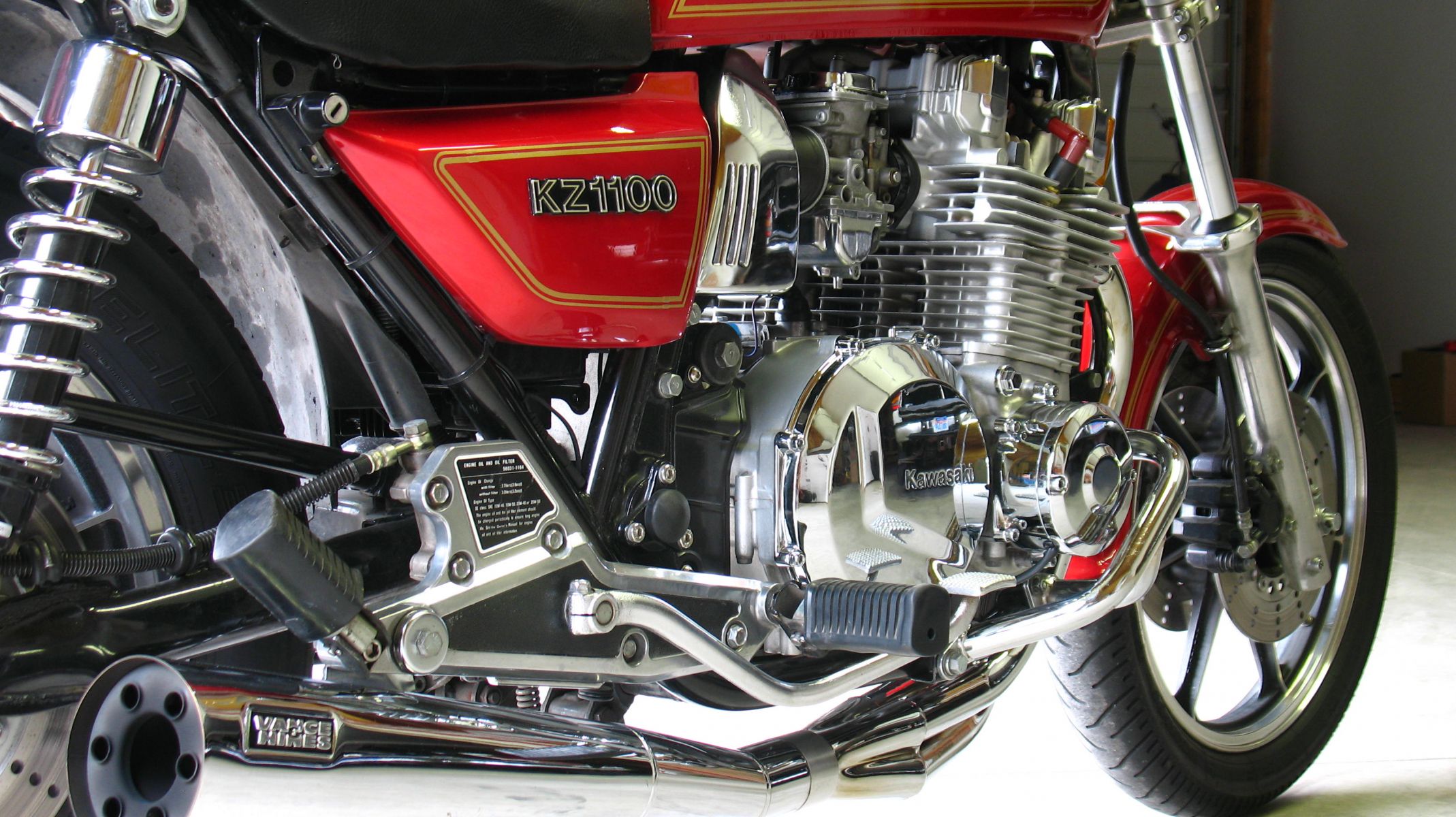

  • PLUMMEN
  • PLUMMEN's Avatar
  • Posts: 7986
  • Thanks: 104
Re: 10,000 rpm's
11 Aug 2014 16:40
#643522
That's a nice looking bike! :) They look tan to me anyway. ;)

Re: 10,000 rpm's
11 Aug 2014 16:53
#643526
PLUMMEN wrote: That's a nice looking bike! :) They look tan to me anyway. ;)
She's there...I think.
It runs pretty good for using a low-tech Motion Pro Carb tool, and Gunson Colortune for the mix. It has never ran better (since I've owned it).
I'm done...just wanna ride! :woohoo:
