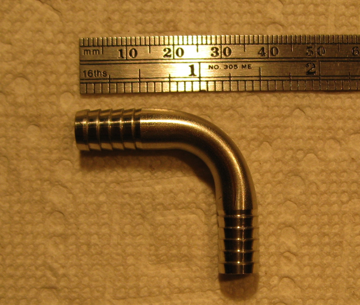

Even a slightly kinked fuel line will restrict flow. You do not need to buy a 90 degree filter. Just buy a 5/16" stainless steel elbow (see image below) and eliminate the kink. Some propane dealers sell them. Ed
