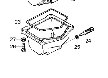

I suspect your carbs are the same as mine - Keihin CV34
If the float valve/needle valve is good and the brass seat into which it goes is clean ( Q tipwith carb cleaner and or Brasso) and is not the source of the leak then the only things left are the drain screw O ring like gd4now suggested or the brass overflow tube in the carb bowl. These do develop hairline cracks which can be hard to find
You can just see the tip of the brass tube in the schematic above. You can test for leaking by filling the bowl with water, connect rubber overflow tube to the nipple on the bottom, put a finger over the top of the brass tube, blow in the rubber tube and look for bubbles in the bowl -the same technique you might use looking for a puncture in an inner tube.
I have had to repair one of mine. If this turns out to be the source of the problem the JB Weld allowed to fully cure will work or what I did was toe get a piece of slightly wider copper or brass tube at a hobby shop, slip it over the existing brass tube and solder at the bottom.

The carbs are Keihin CV34s identical to the diagram JR posted. I'm doubting it's the o-rings because I've had to drain the bowls frequently during this whole process and I would think that if the o-rings were bad they would drain completely? I could be wrong, but that's just my guess.
Anyways, I'm planning on checking the float levels with a clear tube and I will also check for cracks in the drain tube itself within the next couple days.
