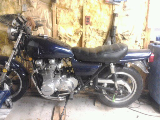

My fault, the RS carbs. I've had issues with the older carbs and thought that carbs with newer technology would perform better. I may just have to find somebody to go thru my 26"s. I purchased this 78 1000 with 29"s for $500, then i sold the 29's for $550 on ebay so basically the bike was free. But i shoulda kept those 29's!

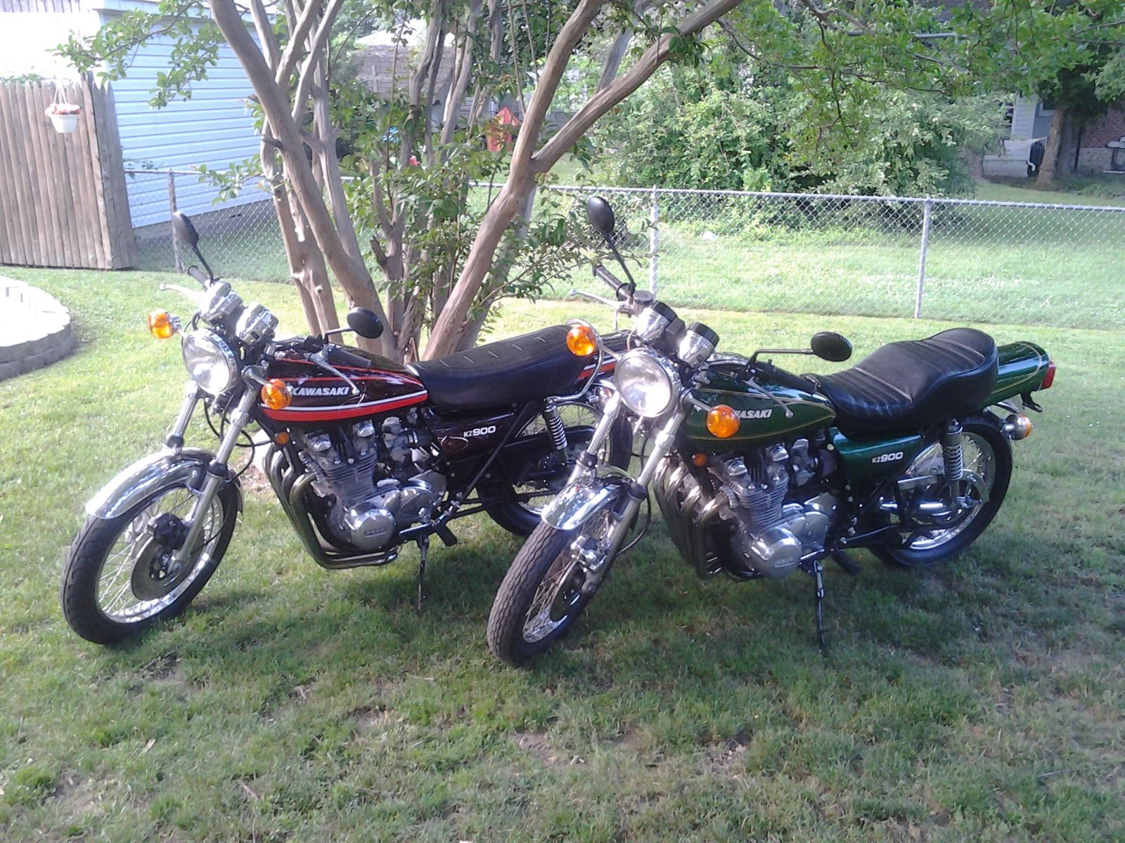

Thanks to all for the info. Yea Larry i'm glad i joined this forum so i can gain some knowledge and don't waste my hard earned $$$! I have 2 76 900"s with 26's and both of them run but i don't like the throttle response on one and the other the choke acts up and is hard to start sometimes.
