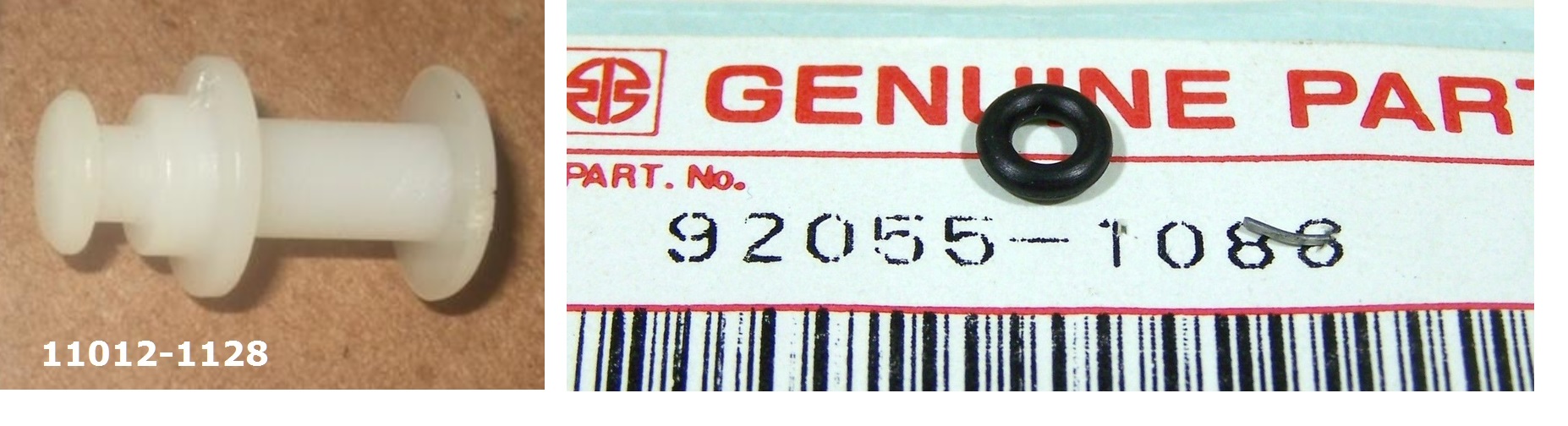

I have an 82 KZ750 H3 with Keihin CV34 and these carbs have an off white plastic or polyester "cap" over the end of the pilot jets. What is purpose to have this cap there and how can the pilot circuit work when its capped??

The plug or cap on the pilot jet is supposed to prevent fuel from being drawn into the pilot jet except through the tiny passageway shown in the diagram.

How do I safely remove/replace these w/o cracking or destroying them? I imagine theses are all but impossible to find replacements.

The plug is held in position with an o'ring.
Could pull gently and carefully to see if the plug will come out.

I think you're thinking of the metal plugs that cover the pilot adjusting screws (air mixture screws) on the outside of the carb body. The polyester caps are for the pilot jets & I'm pretty sure they're necessary for the pilot circuit to work. Z1Enterprises.com doesn't seem to list those caps any more.

azman857 wrote: Why save them? Outside a 100 point restoration why bother keeping them?
Because it won't run right without them.
As Martin pointed out, he is not talking about the mixture screw covers. He's talking about a cap inside the carburetor, as shown in Patton's drawing.
