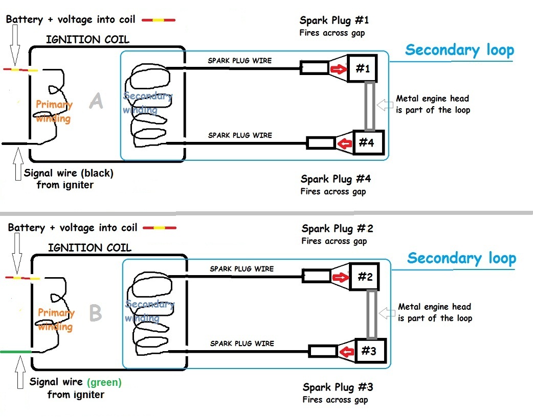

30 May 2014 12:22 - 30 May 2014 12:28braap.jeremy wrote: ...1984 KZ750 (4 cyl)...pod filters...Brand new NGK BR8ES plugs (what he was previously running.. is this correct?....
The "R" plugs are likely resulting in weaker spark due to adding resistance (via the plugs) in addition to the stock resistance component already in the secondary loop (which is usually resistor plug caps).
It's okay to run without any resistance component whatever in the secondary loop. But in any event, should never include more than one resistance component in the secondary loop, which single resistance component may be resistor cap OR resistor plug wires OR resistor plugs.
Unless already running solid metal core plug wires with non-resistor caps, would remove the "R" plugs and replace them with the proper NGK B8ES (which are usually readily available).
Weak spark causing incomplete combustion is sometimes misdiagnosed as a carb issue.
