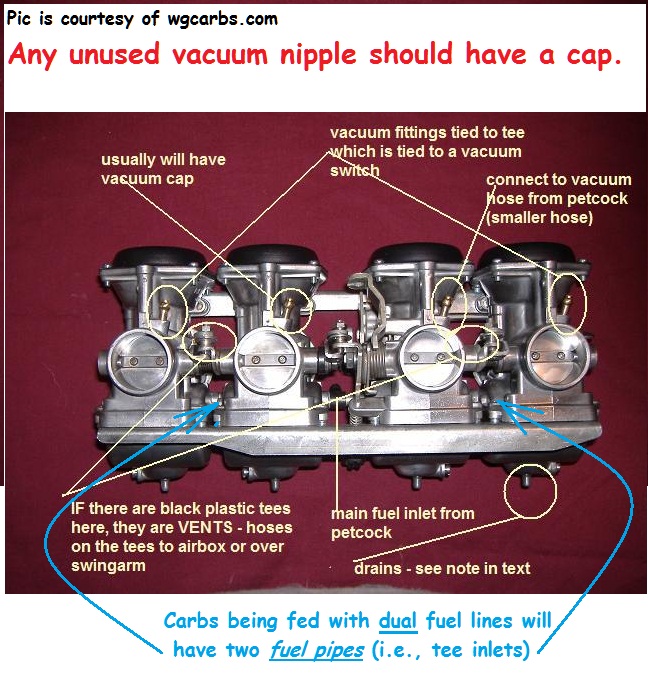

Are you sure that's a vent? I'm not familiar with your carbs, but I am not aware of Kawasaki carbs having a vent between carbs 2&3. Got pics? Ed

Vacuum nipples should be capped/plugged unless being used for another component such as petcock or clean air system.

Sorry its between 3 and 4. They are Keihin carbs that I believe are cv.
