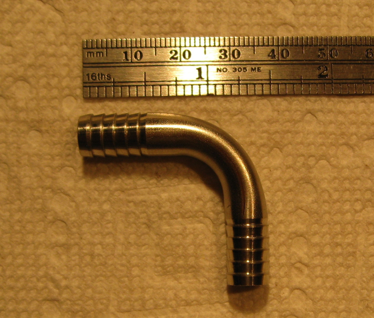

The original hoses were metric, but here’s what I use and it works perfectly. Goodyear 5/16" Fuel Hose SAE 30R7 (required 8") Part # 65123. Here is a link describing it -
www.goodyearep.com/ProductsDetail.aspx?id=10526
I bought it at
www.applied.com/apps/directory/storelocator?r=US&a=20853
Applied Industrial Technologies is nationwide, so there may be an office near you.
For clamping the hoses I use 5/16" spring clamps (see 1st image below). They are a million times easier and quicker to use than the screw type. Some auto stores sell them or they can be easily found on eBay.
I use a Golan Super Mini 5/16" fuel filter; see "70-312G 5/16 Barbed Fittings” at www.golanproducts.com/filters.html#filters-mini for specs. (See 2nd image below). They are not cheap, but one will last a lifetime; I got mine from ronayers.com. They use a stainless steel filter element that can be cleaned. They filter out very small 10 micron particles but still pass fuel at a rate of 6 gallons per minutes – MORE than enough for any bike. They are very small so they fit well under the tank. Also, I used a 5/16” stainless steel elbow to make the bend from the tank to the carbs so there is zero chance of the fuel line pinching (see 3rd image). I got it at a place that specializes in propane supplies.
I suspect all this seems like a lot of fuss over fuel delivery, but it works great, makes removing the fuel tank a 30 second task, and it will last for decades.
One word of warning – having tried numerous fuel delivery setups over the past 37 years the absolute worst product I found is Gates Barricade fuel line. Do not waste your time and money on it as it has an inner sleeve that rolls up like a loose sock and clogs the line when you install it. Ed

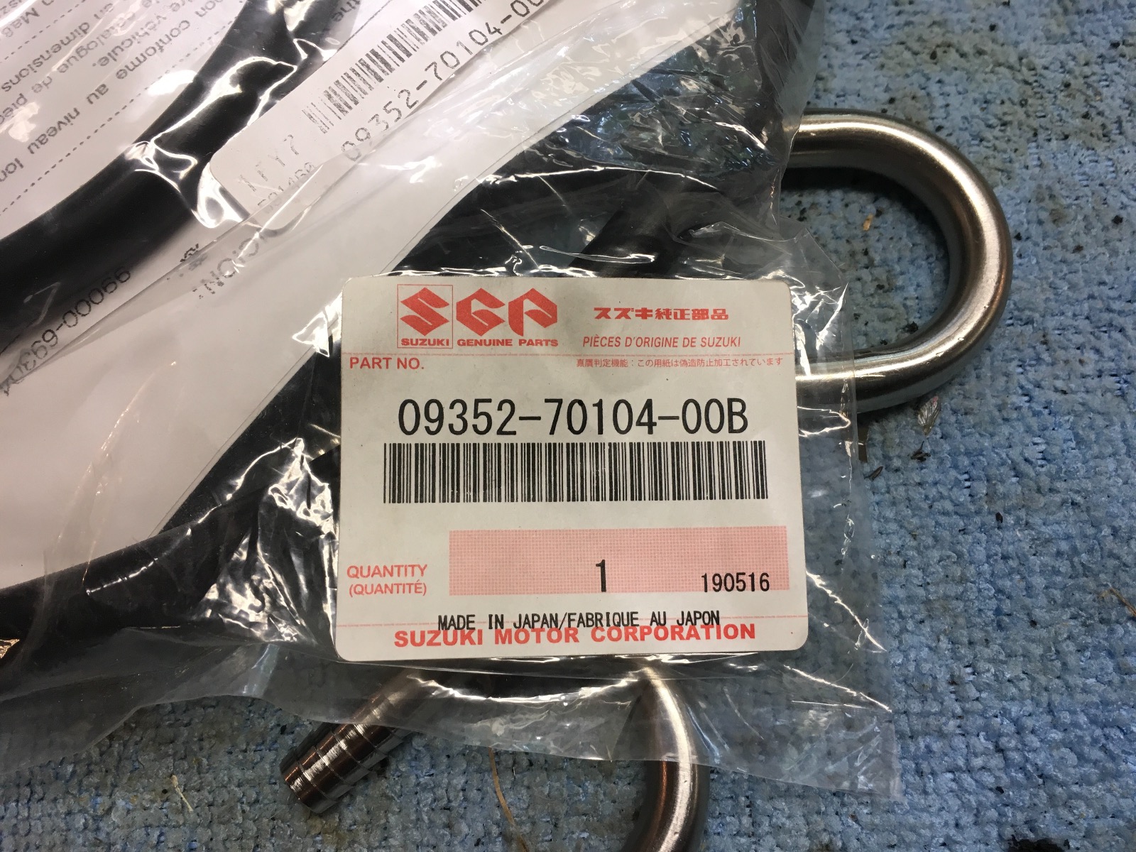

I would think so. I use 5/16 on my 900’s and 1000. I have had good success with this. Suggested by Nessism
The following user(s) said Thank You: Nessism, KZ1000LTDPENNSYLVANIA

Does that Suzuki hose compare to OEM Kawasaki petcock to carb fuel line OD/ID?
- Posts: 7926
- Thanks: 3297
Re: Fuel line and filter
30 Sep 2020 04:43asphalt900 wrote: Does that Suzuki hose compare to OEM Kawasaki petcock to carb fuel line OD/ID?
It's 7mm ID and fairly thin. It's not prone to kinking though. Fits the petcock and carb nipples and seals w/o the need for hose clamps.
