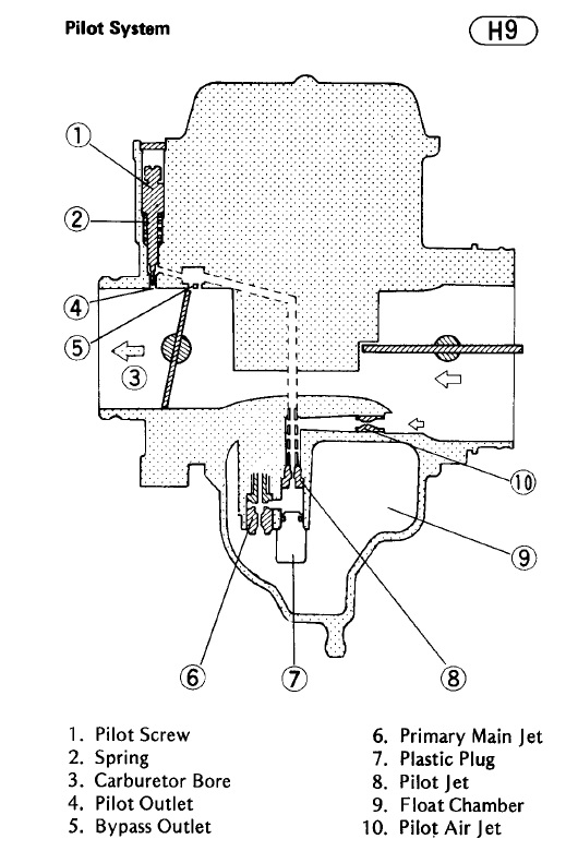

05 May 2014 06:59 - 05 May 2014 07:17jumpship wrote: ... Keihin CV34...sputter from 0 to 1/8 throttle (hesitation). Mostly and 100% problem happens when rolling out of first gear from a dead stop
Analysis: Doesnt happen with slight choke on...mixture screws are screwed all the way down to be seated lightly...Needle is an after market with the clip on the lowest (richest) setting...issue seriously only happens 1/8 throttle at low RPMs....
Mixture screws should not be "seated," as they are designed to regulate volume of fuel mixture drawn into the combustion chamber via the intake port.
Adjustment of the mixture screws is an important part of the tuning process, especially for proper idle and smooth strong pull-away.
The default position of the mixture screws is usually provided in the service manual, and may be such as 1.5 or 2 turns out counterclockwise from lightly seated.
Last edit: 05 May 2014 07:17 by Patton.

05 May 2014 07:44 - 05 May 2014 07:46jumpship wrote: ...Clymer's said the more in you go the richer,and the bike is definitely asking for fuel which is the only reason why i went all the way in....
CV34 carb has a vacuum operated slide, and does NOT have a manually operated slide.
The Clymer is likely addressing a manual slide carb with a pilot air screw, and not a CV carb with a pilot "mixture" screw.
The side-located pilot air screw on a manual slide carb allows more air into the fuel mixture as it's turned out counterclockwise, and less air into the fuel mixture as it's turned in clockwise.
In the case at hand, would start with 2 turns out from lightly seated.
Last edit: 05 May 2014 07:46 by Patton.

05 May 2014 09:02
You shouldn't need bigger pilots. Not available anyway.
Screw 2 turns out from lightly seated like Patton said. Factpry setting is 2.
Check for blockage at point #5 in Pattons diagram. Look for 3 holes in that position and you may have to poke them with a fine wire or bent pin. Often overlooked in a carb cleaning

Here's what I did on my 1 hour lunch. I started at 2 open, and results were very similar, than I went to 4, got a bit better. And believe it or not I went to 6 turns out, and the moment I started her up and got on the bike the issue was resolved and i mean totally! But after riding around for like 10 minutes the trouble came back. And the idle would be normal but drop suddenly.
1.Because of the inconsistencies I'm thinking she probably needs a good clean in section 5 on each carb??
2. Do u think I should have rode around each time I made an adjustments on the screws? Cause I only revved the bike a bit to hear the hesitation and that's how I determined to keep backing out
