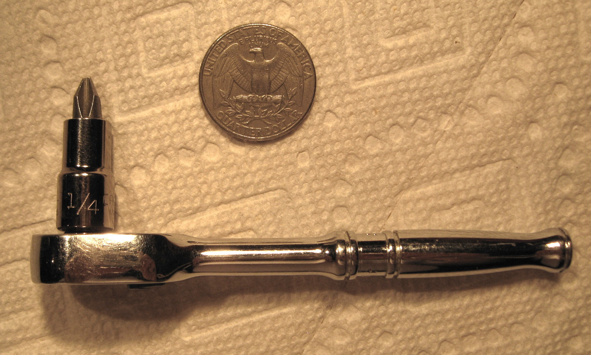

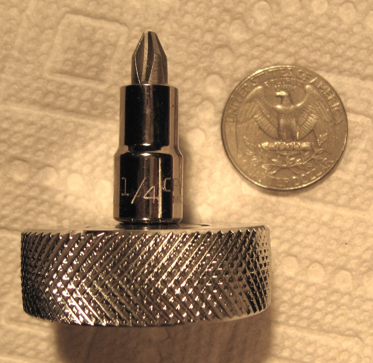

When working in tight spaces I use one of my screwdriver tools shown below depending on the situation. You might be able to use one like them to let you count how many turns you rotate the pilot screws. Ed

A right angle drill adaptor works well in tight spaces-the bits from a magnetic set will work in it. Home Depot, Sears,Lowes, etc sell them.

I cut off an old spoke and ground it down to a reasonable tip. The nut from the spoke makes an adequate handle.
