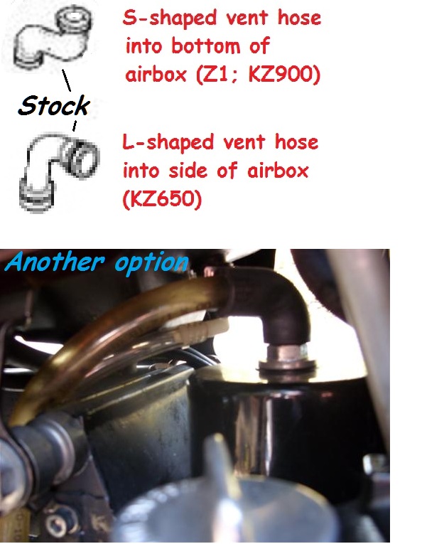

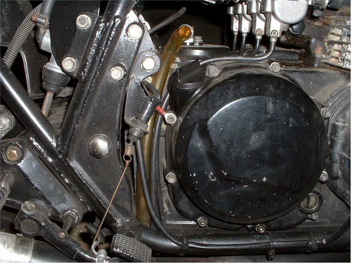

Here's an optional routing of a breather hose, down past the swing arm to exit underneath the bike.
The following user(s) said Thank You: danpcali

Thanks Patton. This is my first bike and I'm still learning. When I bought the bike the crankcase filter was installed. I plan on taking it off and following the advice you and Ed gave. I don't have the stock L shaped hose but was wondering if anyone has used materials purchased from Home Depot or Lowes to construct the L shaped hose? If so, any specific hoses, material, etc I should use?

28 Apr 2014 16:59danpcali wrote: ... don't have the stock L shaped hose but was wondering if anyone has used materials purchased from Home Depot or Lowes to construct the L shaped hose? If so, any specific hoses, material, etc I should use?
When sizing the "L" and hose, try to maintain an interior diameter as large as the exit hole in the breather's nipple, so that there's no restriction anywhere along the routing between the breather cap and exit underneath the bike.
The "L" fitted to my Z1 was an off-the-wall item at AutoZone that happened to fit fairly snugly onto the breather cap nipple. Just snug has been tight enough and without any tendency to pull off, as there are no forces pulling on the hose.

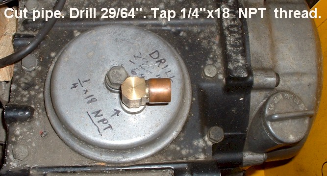

Here's another option ---
The following user(s) said Thank You: stagchr, danpcali
