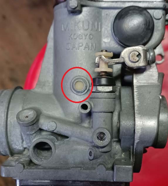

I broke out the big can of Gunk carb dip and put one body in for a few hours. At some point I remembered that the carb bodies all have that little piece of what looks like nylon in the side to keep the slide from rotating. Then I started thinking about all of the balls that block off the drill paths for the internal passages. Those look like they are glued in place with something similar to permanent loctite.
The carb dip clearly says to keep it away from plastic, and that little tab is pretty clearly plastic. Is it really safe to put the body in carb dip? Has anyone had any issue with that one bit of plastic, or the ball plugs coming out?
This is not my picture, but it shows the nylon piece I'm talking about:
On the other hand, the carb dip does work very very well to clean up the bodies.

The VM24 carburetors on my 1981 KZ650-CSR have those nylon/plastic plugs circled in your pic.
I soaked the carb bodies in the good/original Berryman's carb dip overnight and they were unaffected.
This was years ago. I just now checked them just to compare and they look the same as yours.

We've not used Berryman's exactly because of concern about that plastic nub. Others likely have used it without ill effects.

Berryman's won't hurt those plastic inserts. I've cleaned countless sets of VM in Berryman's and never had a problem. What will happen, though, is the zinc bodies will turn dark if you leave the carb body in the sauce too long. I try to minimize the dip time for that reason. Also, if your dip is well used, and black, that will contribute to the carb bodies turning back faster.
