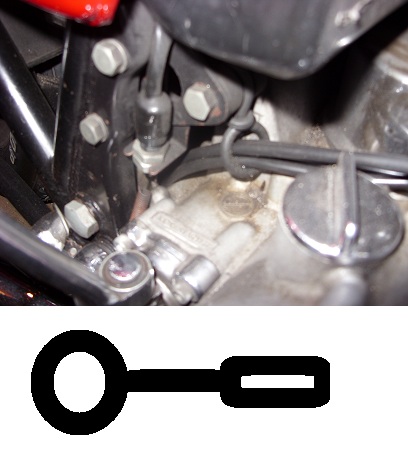

Assuming your petcock and carbs are stock 1977 KZ650 items routing the lines is easy. The fuel supply line runs from the petcock to the “T” fitting that is between carbs 2 and 3. There are 2 vent tubes that attach to the upward facing ports on carbs 2 and 4. These tubes should run up and toward the rear of the bike terminating in open air near the top of the airbox. There also are 4 small tubes that are attached to the very bottom of the carb bowls. These are overflow drain tubes and should be routed from the carb bowls down to the space between the rear of the engine and the front of the swing arm pivot and should point down toward the ground so any fuel that may overflow will drip on the ground. There should be a rubber holder (see picture - officially called “clamp, over flow pipe” part number 92037-134) that attaches to the right side of the engine near the rear. The 4 overflow tubes should be routed through this as they head downward. According to Kawasaki.com that part is still available if yours is missing. Ed
