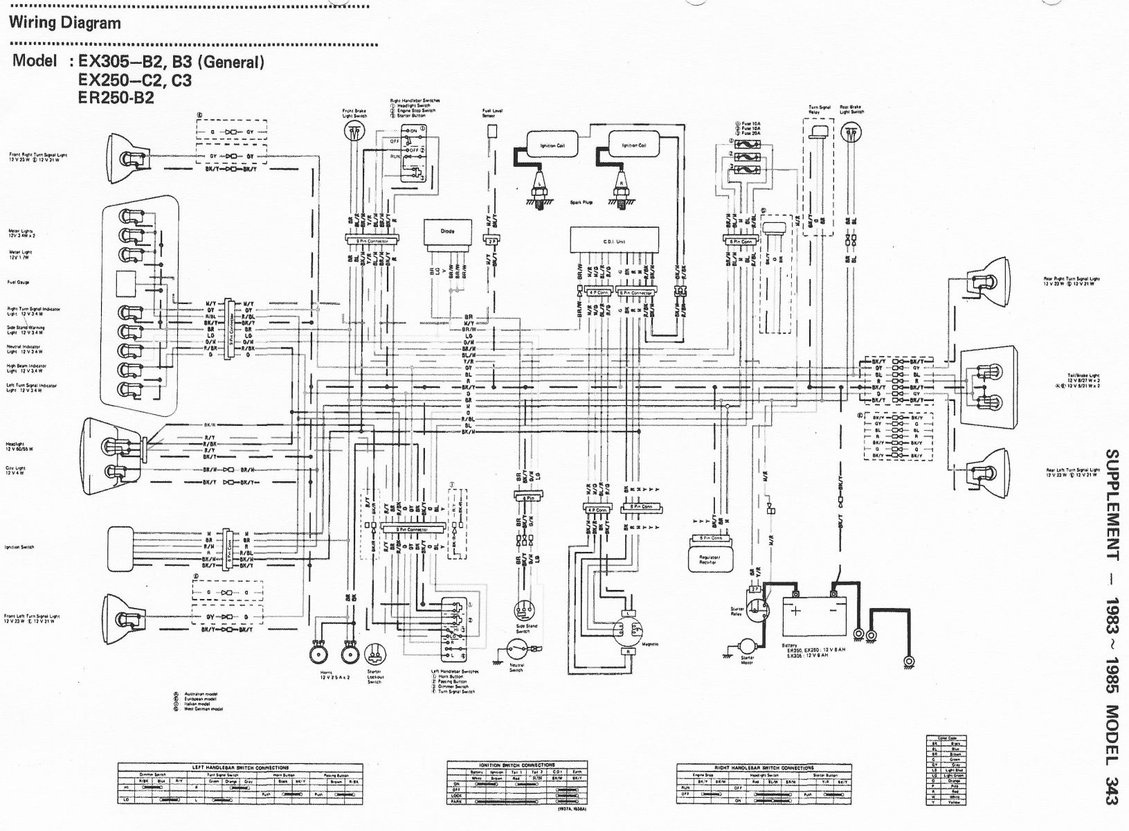

Forgive some wild guessing, but if not already done, would check into what the FSM says about the "pulsing coil" and the "igniter" as to whether and reasons either or both might fail at higher rpm.
www.gpz-305.de/img/Dokumente/Schaltplan_EX305-B2-3.jpg
And assure that the igniter has a good ground through the black/yellow wire.
