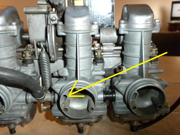

Let's start from the beginning. No 1979 KZ650 ever came from the factory with VM22SS carbs; they all came with VM24SS carbs. The VM22SS carbs were only original equipment on the 1978 KZ650-B2A and 1978 KZ650-D1A. So, I suggest you take a look to see if the bike is indeed a 1979 or if the carbs are in fact VM22SS carbs. If both of those things are true, some previous owner changed the carbs. If your carbs have the orifice at the 10:00 position as shown in the photo below, they are VM22SS. If that is missing, but the carb bodies are ribbed like the ones in the photo, they are VM24SS. If the rider's footpegs are attached to the frame using one bolt on each one, the bike is a 1978 or 1977 model. If each footpeg is held to the frame with 2 bolts, it is a 1979 or later model. Ed

Its definitely a 79, Two bolts holding the pegs and I just came in from pulling the carbs out. They do not have the orifice at 10 O'Clock so, they are in fact VM24SS.
