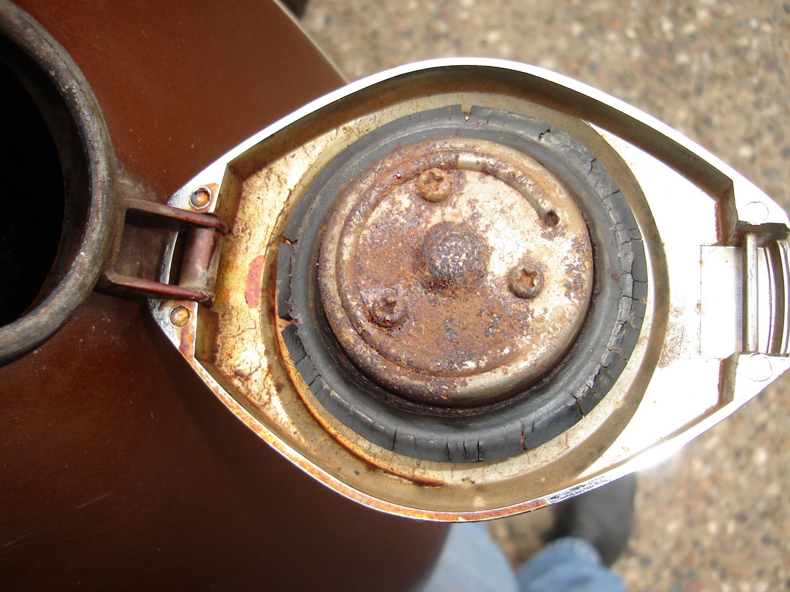

hi kzr's
greetings from across the pond!
does anyone know how to check
the gas tank vent lid please?
I can't find anything in the kaw
workshop manual.
i keep hearing a hissing noise
from the gas tank lid, when I open
it up. my bike starts, then cuts out.
the carbs, choke and electrics have been
checked.
Many thanks riders and wrenchers!
Angel

- Posts: 8018
- Thanks: 1645
Re: kz750 ltd gas tank vent
13 Oct 2013 16:21 - 14 Oct 2013 12:21
I think the 750-4 fuel cap is vented thru the key lock. Try spraying it w a carb cleaner or wd40 to give it a flush. If you use carb cleaner or any other solvent, it probably should be lubricated afterwards. You could take it apart, but be aware that there is a big spring that could send stuff flying, hitting you in the eye.
If the rubber gasket is hard, replace it. Hopefully yours isn't as bad as the one in Rainman's photo.
