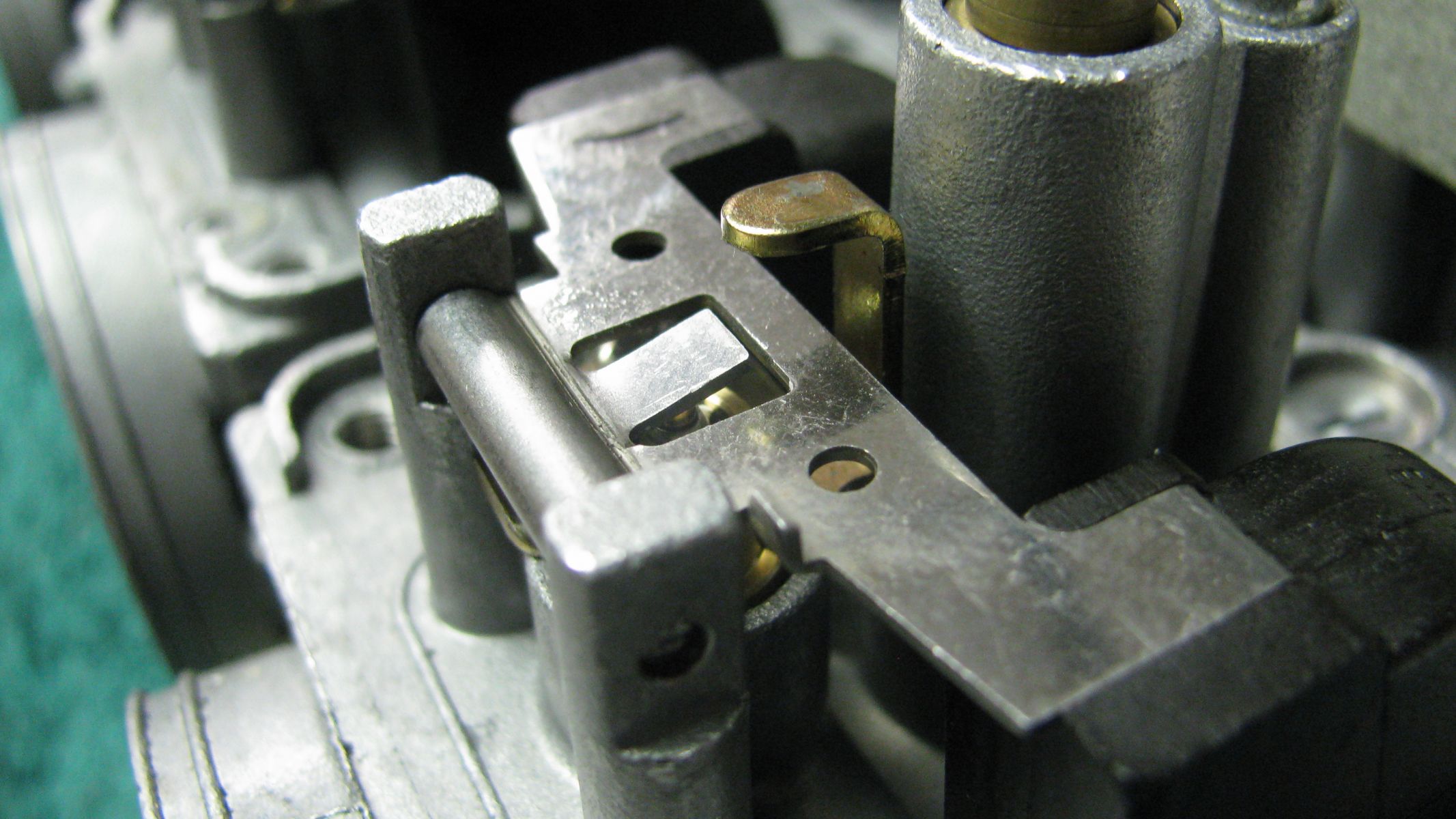

Im almost finished building my first set of BS34SSCV carbs for my KZ1100 Spectre and the float
tabs seem to be bent to the extreme in order to set my floats to 18.5mm per the manual. Im using valves from an ebay rebuild kit. Anyone seen the tabs this extremely bent before? When the valves close the pins are being pushed sideways abit.

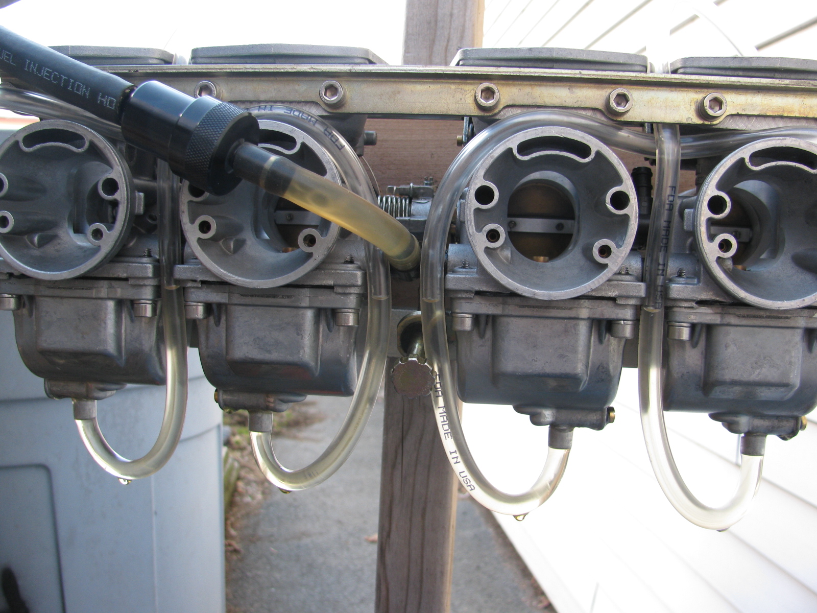

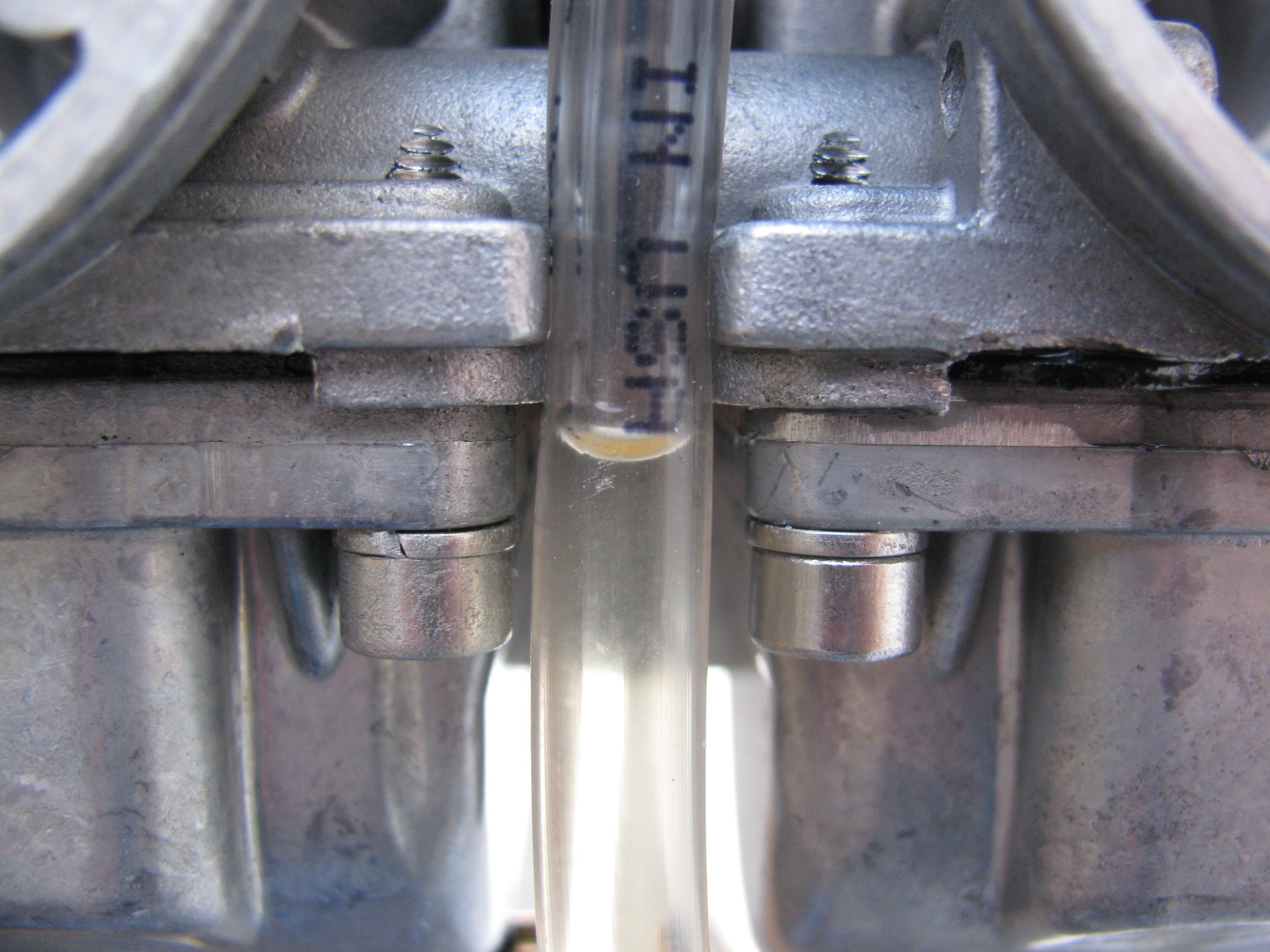

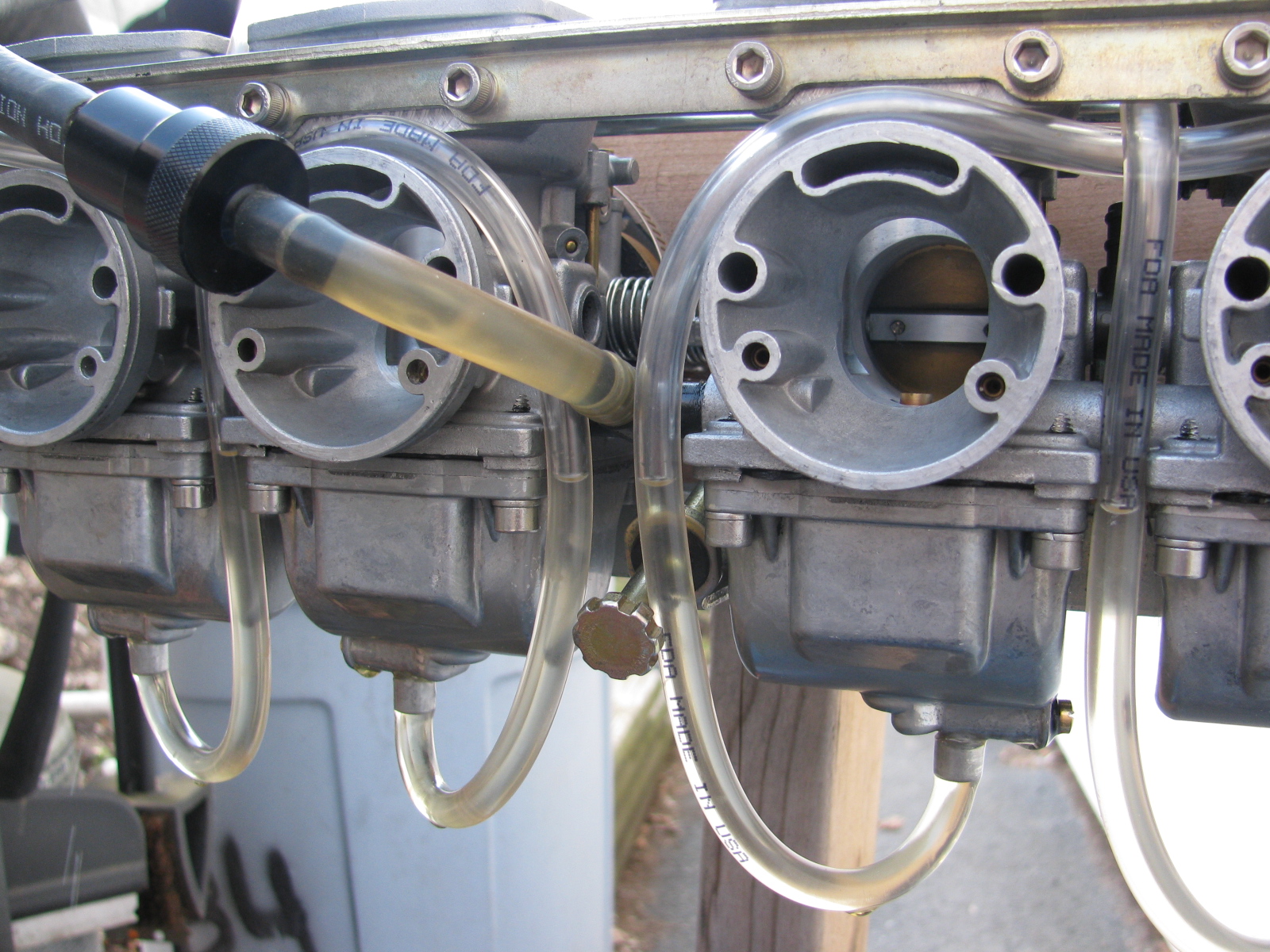

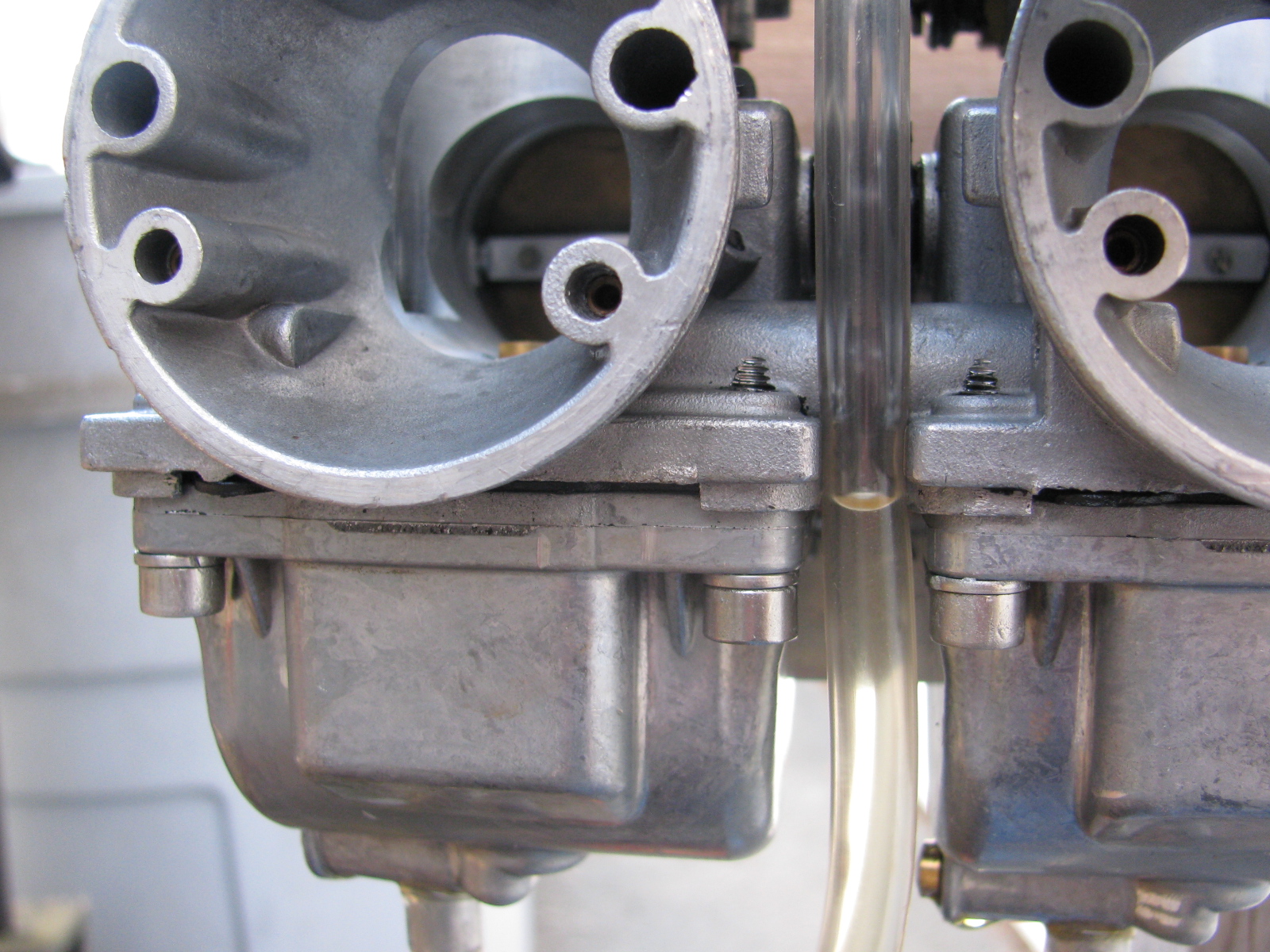

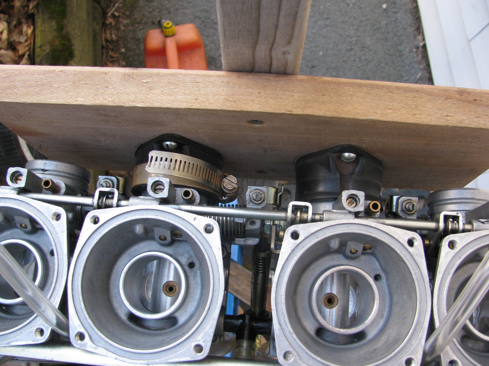

I tested them and found that the fuel is around 3mm from the bottom surface of the carbs. Im surprised to see that for some bs34s the floats are set at 22.5mm and for the Spectres, manual recommends 18.5, if the bike is on sidestand, the gaskets are soaked. I soaked ATF into the gaskets before assembling, supposed to prevent sticking. Im posting pictures in case it helps anyone learning this like I am.
