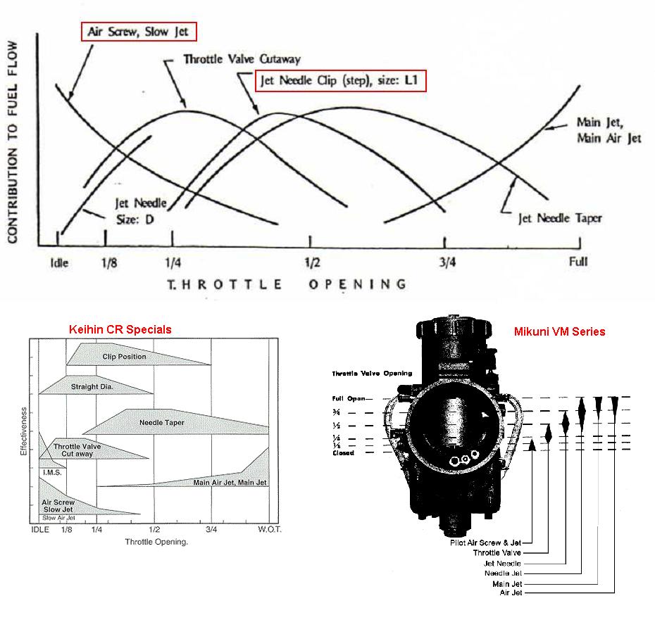

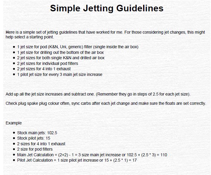

Key notes to LEAN condition..... "Bike used to run well, and rev to the red zone with no problem. " & " discovered that float level was WAY high"....
Maybe this will help you diagnose your symptoms....
Basic rule of thumb for 4-1, pods (I realize you're using air box), non stock configuration jetting etc....
Follow this link for BS 34 re-build/tuning... One of the best write ups w/images I've come across...
BS-34 Rebuild....
BS-34 Rebuild....

Just because the 4-1 exhaust was on when purchased doesn't mean it was jetted correctly...
Case in point, float level was off thus extra fuel to compensate for the lean condition of the exhaust...
You adjusted float levels to spec now issues (more air than gas)....
