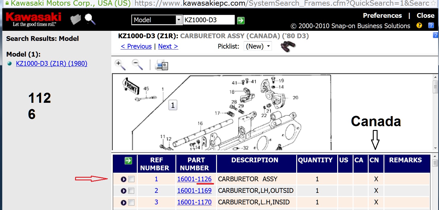

gd4now wrote: ... As I understand it the D3s sold in the US had carbs marked with 1204 and those in Canada with 1126. They are both VM28ss carbs but the ones intended for the US market were jetting leaner to meet EPA standards, than those in other markets.
Glad to learn about the number correlation between part number and number stamped on the carbs. :cheer:
