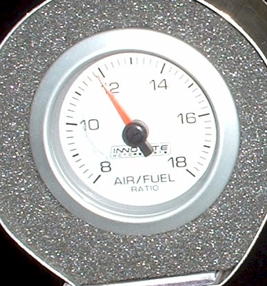

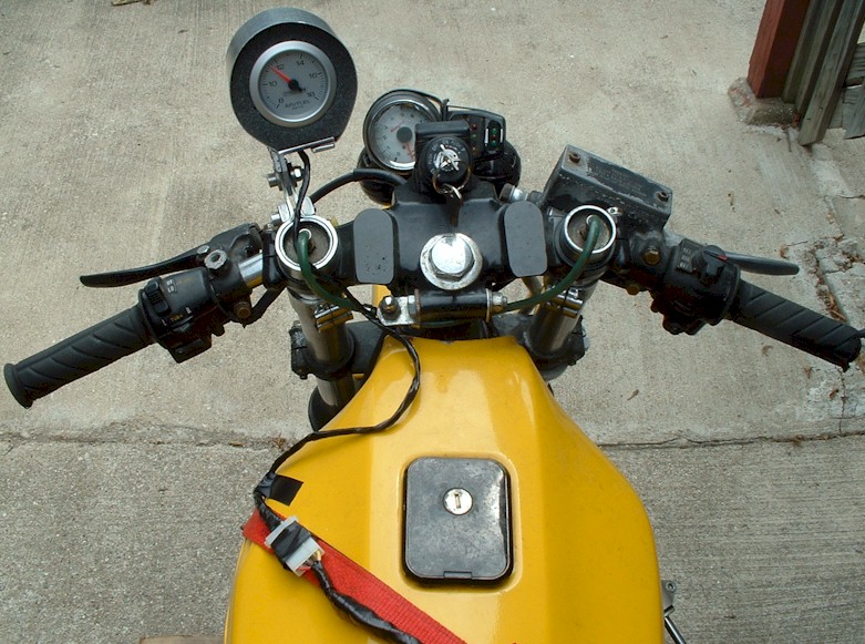

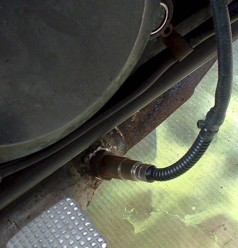

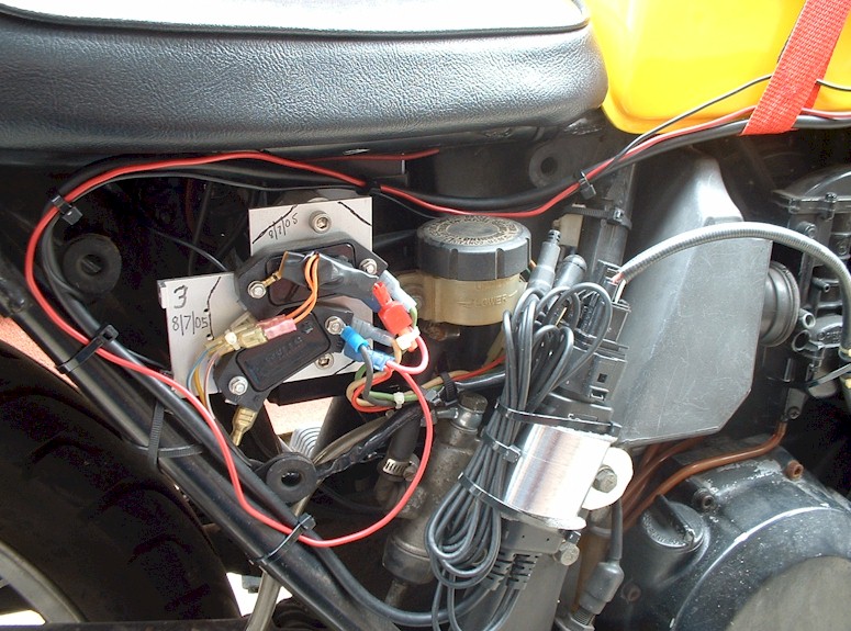

I use the Innovate LC-1 sensor/controller with an analog-servo display. So far, it has worked flawlessly. I've had it for a few years, and at the time, it was getting very high marks for accuracy, and always top ratings in tests. It often did better than higher-priced systems.
www.innovatemotorsports.com
The LM-2 is the flagship data-logger/AFR controller.
The LC-1 is much cheaper, and does not log, but can generate a signal to feed to a logger, or gauge etc.
I only use it to tune carbs, but the controller does have output signals (with many optional signal configurations) to feed o2 data to an injection system.
Innovate has a bunch of different options for data logging as well. The LC-1 is just a small controller, but they have many larger controllers and optional add-ons to give a comprehensive data-logging system.
I haven't tried any of that since I just do seat-of-the-pants o2 monitoring until the carbs are setup, then I remove the system.
I'm not familiar with the AEM brand, but any system with an output should be able to do data-logging on a generic data-logger.
