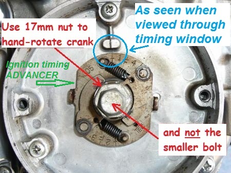

Thanks for the tips Patton, It's has the stock air box which I decided to keep because of all the advice on this forum. Brand new Air filter and no obstructions.
I will check the timing advancer with a timing light once I get my FSM back from a friend, but could you explain where I need to oil? Where are the pivot points?

17 Sep 2012 23:12Advancer weight arm pivot points should be accessible for lube through the timing inspection window.
If the advancer moves quickly back and forth while viewing the timing marks with a timing light and changing rpm by blipping the throttle, may rule out the possibility of a sticking advancer as the cause of the performance issue.
If the advancer is sticking in one position, it should be lubed, and probably both cleaned and lubed.
