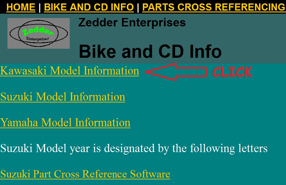

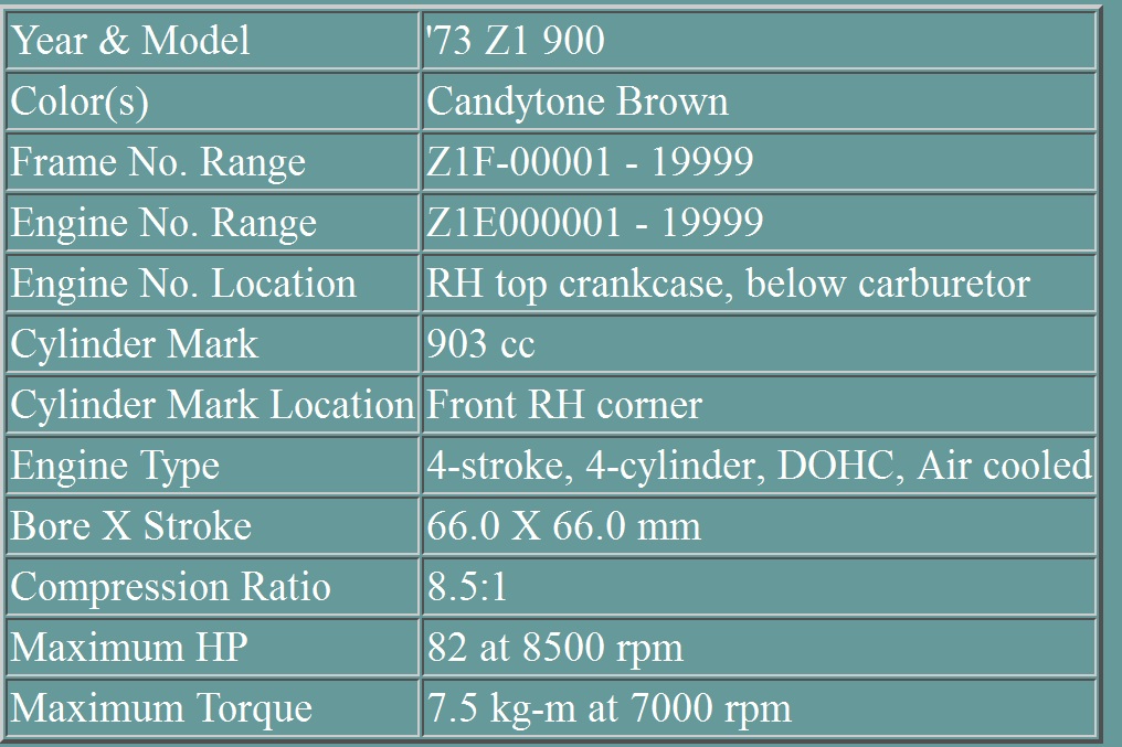

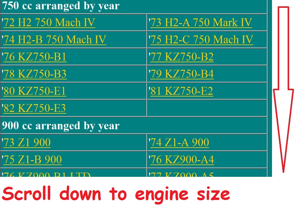

As known, the engine serial number is found on the engine, and the frame VIN (vehicle identification number) is found on the steering neck.
Zedder.com shows the ranges of numbers for engines and frames of many models.
www.zedder.com
Here's an example of using Zedder:
Let us know if able to better identify the engine and frame at hand.
www.zedder.com
