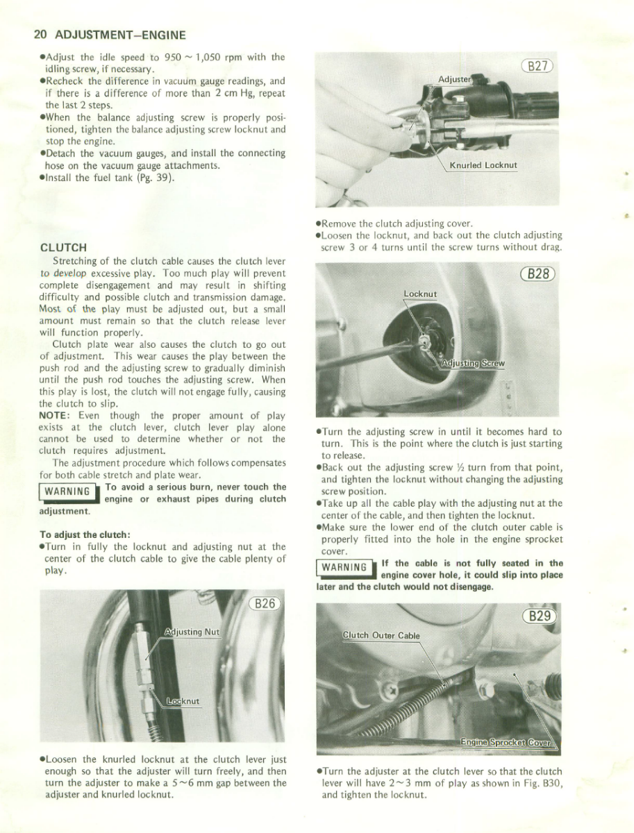

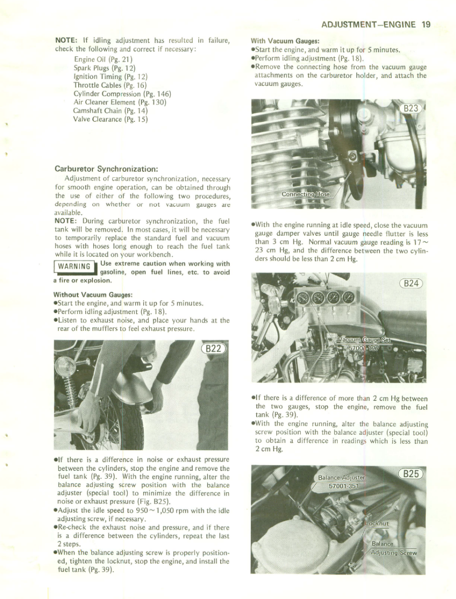

I just bought a 1978 kz750 twin. The link doesn't lead to what it used to. What do I adjust to balance the carbs? The service manual only says you need a special tool. Any help would be appreciated.

You need a carb sync. I suggest Motion Pro or Morgan Carbtune. the cheapy Emgo one isn't very good and I have owned all 3. The special tool mentioned in the manual isn't necessary really, all it is is a long screw driver that passes through a hex wrench so you can lock down the adjustment screw once you have it set. You can buy it at z1enterprises but you can usually tighten the nut without the adjuster screw turning too much or you can compensate by turning it too far so when you tighten the lock nut its perfect.
www.z1enterprises.com/carb-adjustment-tool-set.html
Getting the carbs synced perfectly really makes these twins purr.
If you want the whole service manual PM me and i can send it your way.

Thanks for the reply. I have the entire service manual, I just don't know where on the carb that the balance adjustment screw is. I took the carbs off and cleaned them, but now it is running really rough and leaks a bit from the overflow nipple on bottom. I'm waiting for a rebuild kit to come, and then I'll do the butterfly and idle adjustments, but I still do not know where the adjustment screw for synchronization is located. Is it one of the circled nuts from the first post in this thread?
Also, when should I think about checking the engine timing? could that have anything to do with the rough firing of cylinders?

Thanks a ton for the advice DoctoRot and Patton. Once I get the carb rebuild kit in the mail and I fix the leak, I now know where to adjust for the carb balance. When I get in there again, I'll be sure to look really closely for any cracks in the rubber boots. (When I took the carbs out last, they looked in great shape)
