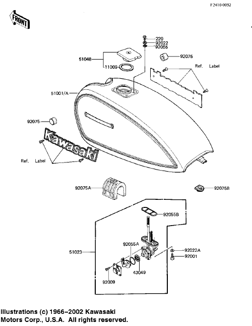

Lots of good info on kawasaki.com, including parts diagrams, part names, part numbers, models sharing same part, availability, etc.
For example, here's a diagram of the 1982 KZ305 CSR (Belt) fuel tank and petcock.
