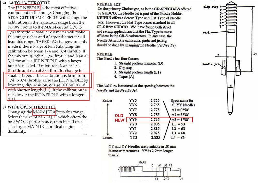

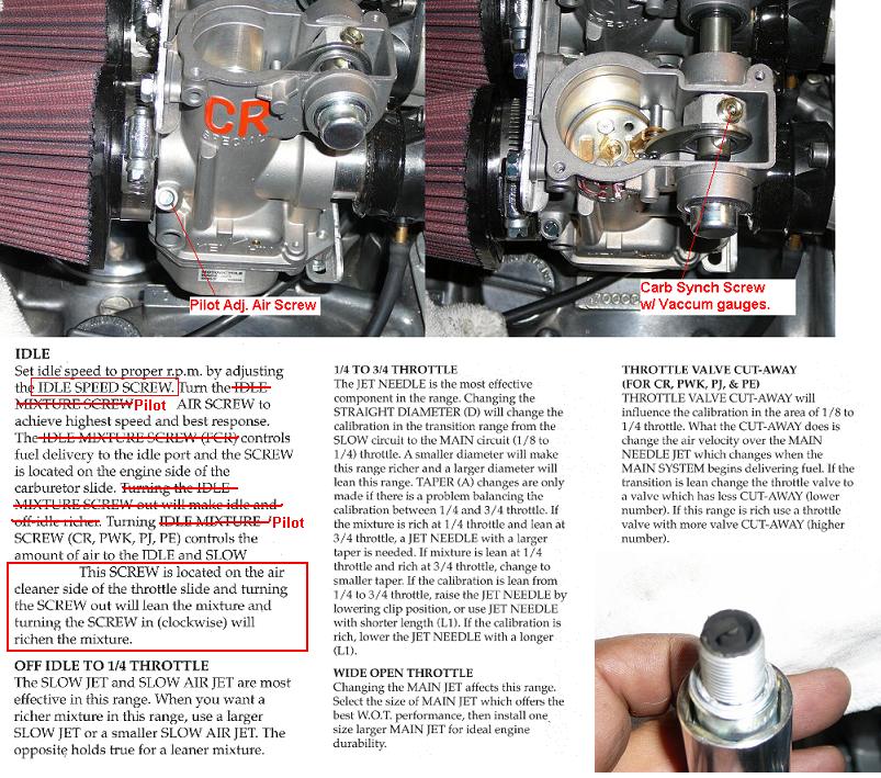

Maybe these will help...
1976 KZ900-A4
MTC 1075cc.
Head: P&P via Larry Cavanaugh
ZX636 suspension
MIKUNI, RS-34'S...
Kerker 4-1, 1.5" comp baffle.
Dyna-S E.I.
Earls 10 row Oil Cooler

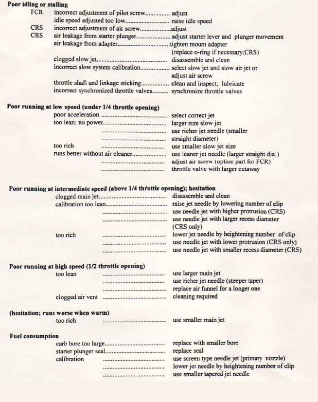

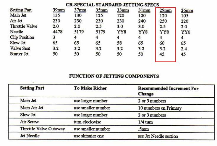

- Old Man Rock
- Posts: 6224
- Thank you received: 225
CR Specials Combined Zip File
Once you get those puppies dialed in, you'll love em...!
