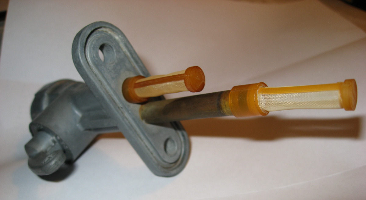

Interesting. I measured the OD of the screen on mine and it is about .0372”. If yours is the same it should in theory fit correctly into the reserve hole in the petcock (see pics below). I measured the OD of my C1’s petcock’s brass tube and it is about .314”. Ed

650Ed,
Thanks for the sizes. I do not have a measuring device.
Will figure out a way to do the precise measurements.
Appears you are measuring an "extra" petcock.
If so : what is the length of the brass tube, from where it exits the petcock to the top of the brass tube?
What do you think about cutting (under)1/8" off, to remove the damaged edge ?
Is there enough length on the tube so that this is not a problem going into the gas in the tank?
Arthur A

The brass tube is 1 11/16" long (see pic). Because the length of the tube is what determines the amount of fuel left in the tank when you must switch to reserve, shortening the tube will reduce the distance you can travel on reserve. Can you use emery cloth to correct the damage? Ed

16 May 2012 12:43650ed wrote: The brass tube is 1 11/16" long (see pic). Because the length of the tube is what determines the amount of fuel left in the tank when you must switch to reserve, shortening the tube will reduce the distance you can travel on reserve. Can you use emery cloth to correct the damage? Ed
Attachment PetcockTube.JPG not found
Thanks for the measurement.
My brass tube is approximately the same.
May risk cutting off the damage and flare end, under a 1/16".
Then use emery cloth to create a slight taper if necessary.
Will let you know how it goes, sometime next week.

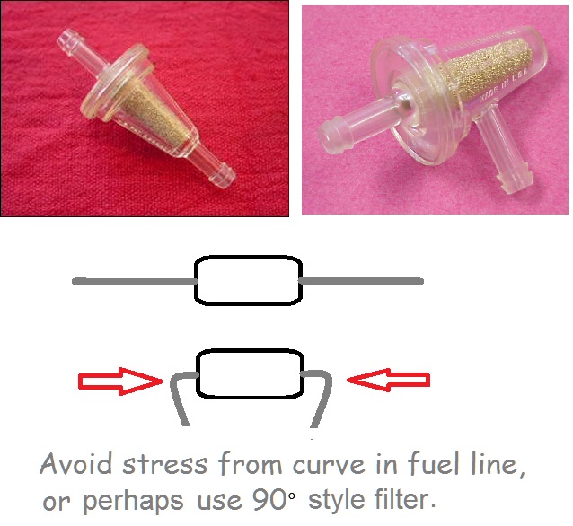

29 Nov 2012 10:52It helps where possible to route the fuel lines so the filter fits into a relatively straight section.martin_csr wrote: ...discovered that the ends get soft & bendy....
Where a tight turn at the filter is necessary, a possible option may be a 90° filter.

29 Nov 2012 15:03martin_csr wrote: Routing isn't the problem. The plastic has softened....
The plastic barbs do indeed soften, but the plastic in its softened more pliable condition doesn't tend to bend and distort when fitted in an unstressed position between relatively straight sections of fuel line.
Routing can be the problem, as the softened barbs may not present much of an issue unless the fuel line is routed whereby the barbs are stressed in holding their shapes by a curved fuel line that's exerting slight sideways pressure against the softened barbs.
