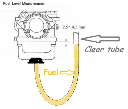

You say you see fuel shooting through the orifices, is this just when the carbs are off the bike?
Is the fuel level correct in the float bowl? Have you done a clear-tube test to see what level they are set at?

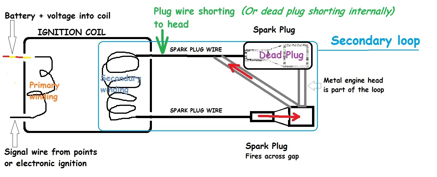

Is #4 compression okay?
Is fat blue spark visible on plug tips with plugs removed from the cylinder head and viewed as the engine is being spun over?
If problem persists, even with good plug spark when viewed outside the combustion chamber, would install a brand new NGKB8ES spark plug (or whatever plug the FSM suggests).
It's remotely possible that #4 plug wire is shorting without interrupting the secondary loop.
Good Fortune! :)

kz750saskatoon wrote: You say you see fuel shooting through the orifices, is this just when the carbs are off the bike?
If needed, here's some info about clear tube testing on Mikuni 29 smoothbores.
To determine fuel level inside smoothbore float bowls, without a side located drain screw, may collect fuel from hole at bottom of bowl.
Some folks adapt a spare 17mm bolt plug by drilling and fitting a nipple to attach the clear tube.
Click > Going First Class
May use a cone shape rubber plug pressed into the drain, with a hole through the rubber plug, and the clear tube fitted snugly inside the rubber plug hole. Then hold the rubber plug in position during the measurement.
Some minimal leakage won't affect the results, as fuel volume entering the bowl exceeds any leakage.
May cut an inch of 3/8 reinforced fuel line. The O.D. fits snug in the bowl drain threads and the clear 1/4 slides inside.
Good Fortune! :)

Yes, I have done the clear tube float bowl test and they all seemed to be in check. I took the carbs apart again and cleaned both the pilot jet and main jet in that carb and I am finally getting it to run on all cylinders.
Here is what I made to test the float levels and this way I could do all 4 at once. It only cost about $8 to make them.
Still might not be outa the woods yet. I gotta get the idle set and see if the carbs need synched.
