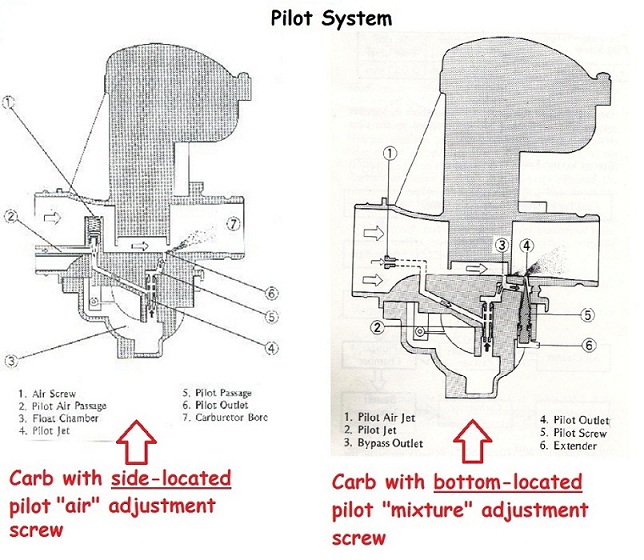

Question, please --
Do the carbs at hand have side-located pilot air or bottom-located pilot mixture screws?

Hey Patton, they are the bottom screw type. They have an o-ring that seals them off and I made sure they all went it to place correctly and didn't tear when I had the carbs off.

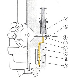

Would assure when choke is OFF that the plunger on #3 carb is fully closed down.
The following illustration shows the choke ON with the plunger raised.
Would assure that the pad on bottom of the plunger isn't missing or damaged, whereby fuel from the enrichener circuit might contribute to an over-rich mixture

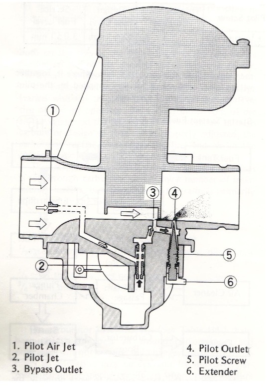

25 Mar 2012 00:36Hopefully the #1 pilot air jet is undamaged and that it's allowing sufficient air into the pilot circuit.
Hopefully also that the #2 pilot jet hasn't been over-zealously cleaned whereby it's been unintentionally reamed larger.

I never have cleaned jets with a wire. I've always used compressed air, so I hope the jet isnt somehow reamed out. It may be worth checking if the #1 pilot air jet passage has something obstructing it though.

Is there any damage to the pointed tip of the pilot mixture screw in #3 carb?
Could swap it with one of the other carbs to see if it makes any difference.
With carbs on the work-bench and the pilot mixture screw in #3 carb is turned all the way in, should be unable to see any carb spray exiting the pilot outlet port into the bore.
When the pilot outlet port is capable of being completely closed by turning the pilot mixture screw all the way in, it helps rule out damage to the port and/or damage to the pointed screw tip.
