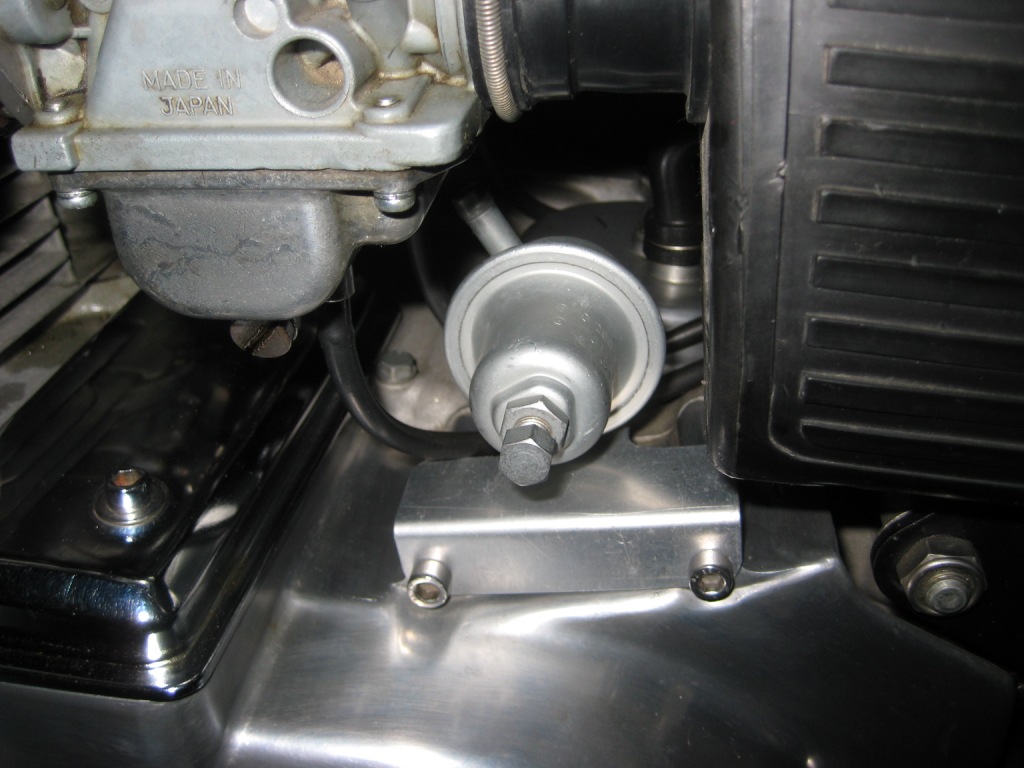

02 Nov 2023 13:12 - 02 Nov 2023 13:14I bought a used adjustable fuel pressure regulator off Ebay that was originally off a Porsche 914, it looks to be of similar size and function to the GPZ1100 unit.I have been dabbling with my 1982 KZ1100B2 which I have put the resistor mod on and a variable pressure regulator.
The bike starts, revs high; pushing a plume of white smoke out the exhaust pipe and stumbles when the throttle is opened. I have played with the throttle position sensor and got the idle to stabilize; however, I am thinking the variable pressure regulator is the cause of this. The pressure gauge's needle is bouncing all over the place.
Is there an OEM Pressure regulator available that's a direct replacement for the stock one?
For example, the fuel injectors from a Datsun are a direct replacement for fuel injectors in the bike. No, I can't find the old one.
I have not used it yet as my DFI build is a long term project : www.kzrider.com/forum/11-projects/619531...injection-conversion
