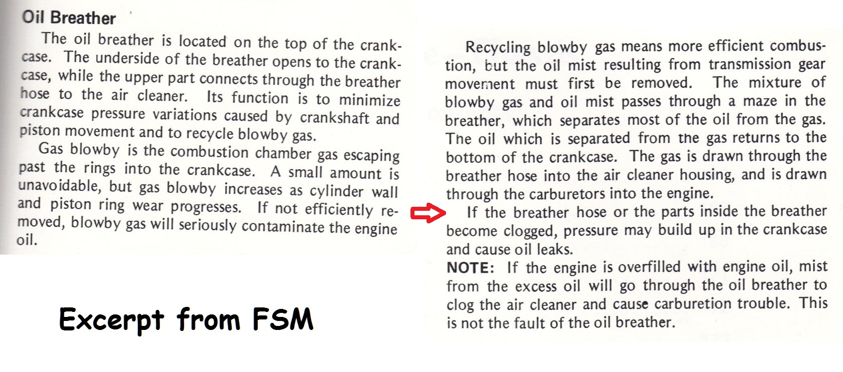

While I was looking around that area, I saw this thing:
[img size=384×512] lh5.googleusercontent.com/-Pwa9c0LLuUI/T...2/20120316000049.jpg [/img]
What is it? Do I need to plug it up now that I don't have the airbox?

Dont plug it. Its an crankcase breather. You can put some tubing on it snd route it back behind the motor or you can put a short bit of tubing on it asnd attach a little filter like this one
www.z1enterprises.com/Air-Filter--KN-621...ent-Filter-2628.aspx
