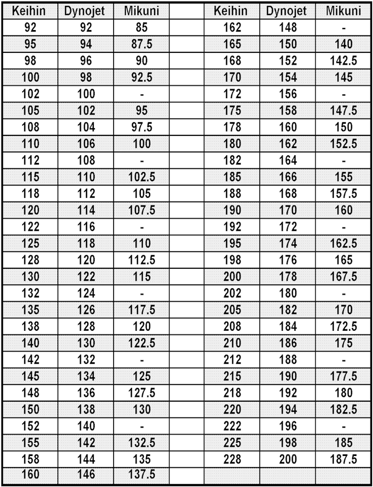

OH yeah, I totally forgot to mention!
ALOT of people are not aware that Mikuni, Keihin, and DJ jets are NOT directly interchangeable, and the numbers have completely different flow rates!!!
Use this chart to figure things out, it really helps:
Good luck!
