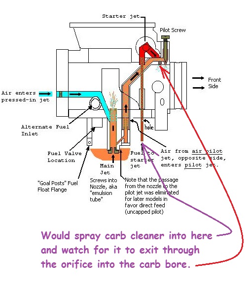

Enrichment (choke) circuits in carbs #1 and 2 may be failing due to blockage.
Attachment KZ750twincarbstartersystemfuel.jpg not found

Fouled plugs as in black and sooty ? to rich ? and hard to start on 1 and 2 .
There is no enricher circuit on those carbs but check if the pilot jets are blocked and check if your choke flaps/butterflies are working on 1 and 2. I've had it happen that the linkage was not operating correctly.
If 1 and 2 are rich and the mixture screws have never been messed with then I would suggest checking the fuel level in the carb bowls - may be to high. Do a search for clear tube method. Patton has great diagrams for this. Having the fuel level in spec is critical. Messing with the mixture screws will not make that big a difference regarding plug color
