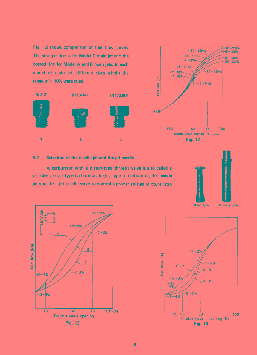

I know this is an old thread and I am way late to add much, but there was much talk about moving the needle up or down. I wanted to add the from a Mikuni carb manual which has a table showing the increase or decrease in fuel flow when moving the needle.

15 Jul 2021 09:09This is incredibly helpful information.I know this is an old thread and I am way late to add much, but there was much talk about moving the needle up or down. I wanted to add the from a Mikuni carb manual which has a table showing the increase or decrease in fuel flow when moving the needle.
