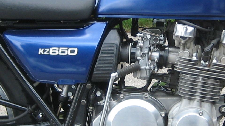

To make the GSXR flat slides (1985/1986) fit the 650-1100 KZ you need to take the apart and fabricate a new choke rod, throttle rod, and upper/lower link bars. It is a bit of work. Here is my street bike with a set fitted to a modified air box.
The carbs are almost identical to the new TM series flat slides so a lot of the parts are the same. The only issue is trying to get a hold of a good used set, the prices on these have skyrocketed in the past few years.
