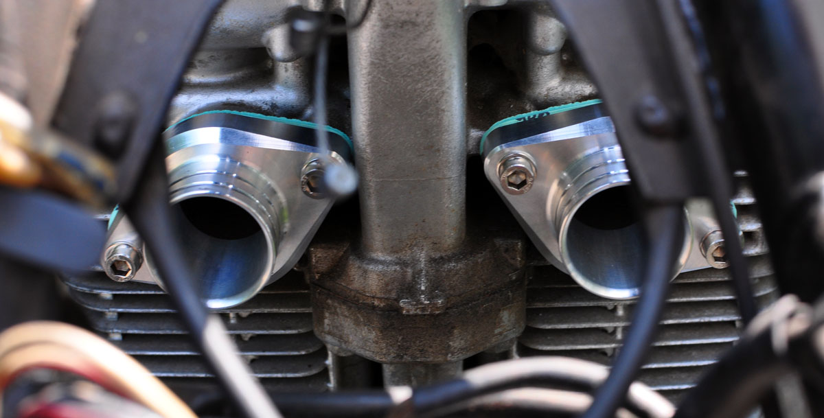

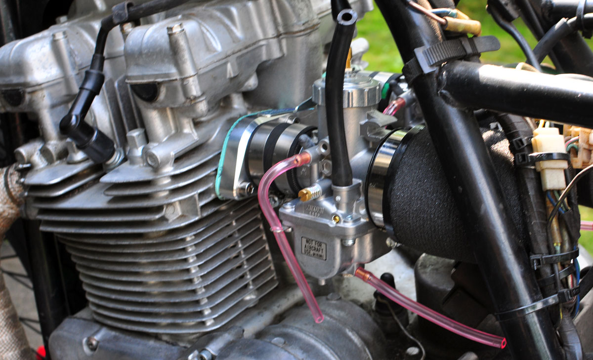

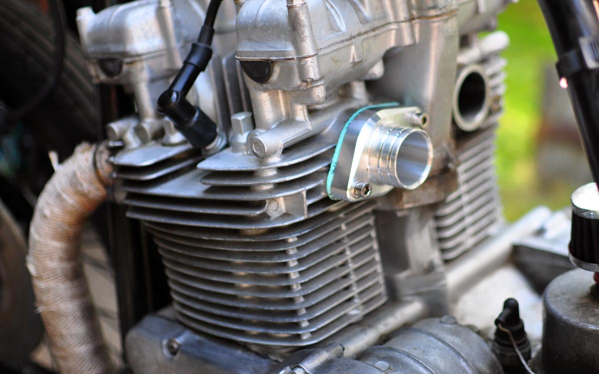

I recieved my carbs on friday, and got to spend some time working on the kz750 twin. Milled the aluminum intake manifolds and made the holes about 2mm narrower on each side so that they would fit on the kz. The manifolds are for a xs650. They bolted right up and I slapped the carbs on.
The bike started up kinda rough, but when i get them synched and got the air screws corrects the bike has never run better! Took it on a quick blast around town, and checked the plugs, and they were nice and tan. I could probably use 1 size bigger pilot because may fuel screws are turned almost all the way in. Now i just have to get on the highway and check them to see what the main jet is doing.
some pics:

Sorry if something like this has been posted too many times. I was just sick of my leaking 38s and hadnt heard of people changing them out...
