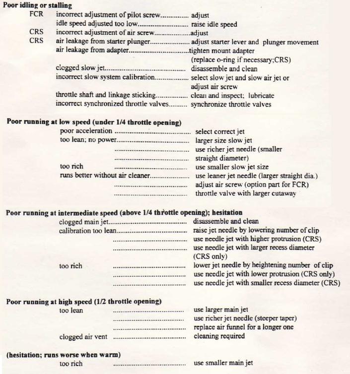

Right out of the Keihin CR T-Shoot guide.... Applies to pretty much the same for all mechanical carbs...
