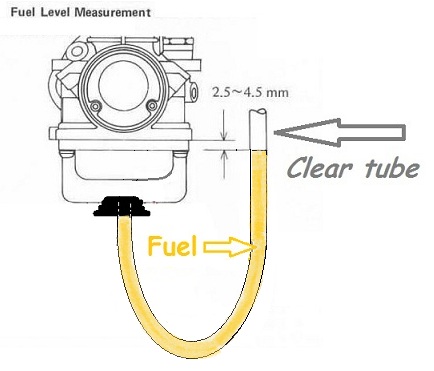

Does anyone know where to get (or how to make) a fuel level gauge tool for these RS34 carbs, so I can do the clear tube test? The drain plug is single purpose and it is very large--takes a 17mm wrench.

14 Aug 2012 15:44Brady 154 wrote: Does anyone know where to get (or how to make) a fuel level gauge tool for these RS34 carbs, so I can do the clear tube test? The drain plug is single purpose and it is very large--takes a 17mm wrench.
Would this work? www.z1enterprises.com/ItemDetails.aspx?item=ZSM-VM29FT

14 Aug 2012 16:42mtbspeedfreak wrote:Brady 154 wrote: Does anyone know where to get (or how to make) a fuel level gauge tool for these RS34 carbs, so I can do the clear tube test? The drain plug is single purpose and it is very large--takes a 17mm wrench.
that may very well work. phone them and find out. i use a drain bolt from an old set of carbs for my rs 34's. I can remember what carbs the drain plug came from though. i just drill and tapped the drain plug and threaded in a nipple, just like that 1 from Z1E.

14 Aug 2012 18:09
The special fitting isn't essential.
I use a clear hose inserted into a cone-shaped rubber grommet. And hold it in position while performing the clear tube test.
Others report using a snug fitting short length of automotive fuel hose instead of the grommet.
It shouldn't leak, but minimal leakage doesn't invalidate the test.

14 Aug 2012 20:50Patton wrote: The special fitting isn't essential.
Thanks Patton--I'll give that a try.
I also looked at that tool on Z1 Enterprises, but I'm not sure if it'll fit. I took measurements of the bolt size and thread pitch, so I'll call them tomorrow and see if it'll work. Would be nice to have for long term use.
